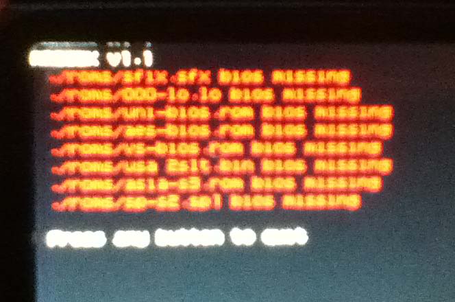

Gngeo Issues
Yes, as Yoshi says, it's a 2-step process.
First you install the Wiz pack "base install", and then you decompress the Caanoo packs overtop of the Wiz install to apply Caanoo-specific updates/fixes.

I'm working on downloading the first 4 files. What I don't understand is why do those 4 files have the same file name as the first 4 file updates. I was thinking they were the same files. If I put the updates in the same rom and romrc folders, they will overwrite the initial 4 files because of the file name.
Don't know what you mean (4 files with the same name?). However, here the full instructions...

This is just getting comical or sad... I downloaded the 4 Wizpak files and put them in the rom and romrc folders and did the same with 8 caanoo updates. Still the same error messages about the bios.
Hmmm, might be a stupid question, but do you know what .rar files are ?
It's an archive of files. Open the first .rar file with 7-Zip and copy the content of the archive as described above (copying the .rar files to the Caanoo is pretty useless).
I finally got it to load. What a real pain in the ass. I'm still not happy completely. The Metal Slug games are my favorite and MS1 shows red on the list and MS 2 is green but says its a bad rom and MS 3 has no volume. What is the best way to fix this? Do I need to download the roms and install separately?

Did you copy the files in the correct order ?
Check your ROMs (CRC) with 7-Zip, they should look like:
I deleted the old rom files that came on the packs and downloaded MS/MS2 roms and used those. They now work. I had to do this with a few other games too. I still cannot get Pulstar and Spin Master to work.
