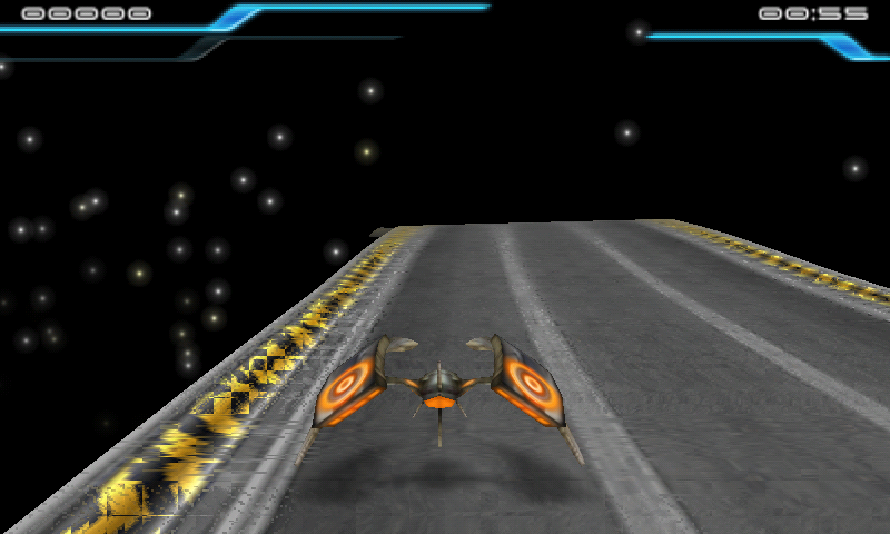

today i got my pandora (yeh!) and i immediately started to continue working on audiorace...
while doing so, i noticed, that the longer the track goes, the uglier the track gets texture mapped. i've done some testings, and i came to the conclusion, that this somehow must be a bug in the current gles driver (i've got hotfix 5 installed iirc).
to be more detailed, i'm increasing the v-coordinate with increasing time/length of the track to get my track continuously textured. my v-coordinate on one track with about ~5 minutes goes up to 1030. this approach works on my windows machine and even on the wiz, and there's nothing i can think about what i could change to fix this on my side.

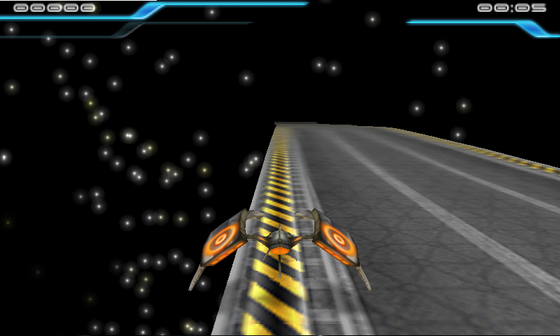

here are 2 screens directly created on the pandora with glReadPixels:
this one is just at the beginning, v-coordinate is very low
this one is just at the beginning, v-coordinate is higher (just guessing - something around 200)
how do i check if i've got the newest driver installed? should i file a bugreport? will the be an update if this is regarded as a bug?

Interestingly, I've seen that also happen on Android when doing exactly the same kind of thing - the textures start to become utterly warped and pixelated.
I had thought it was just another GLES quirk, but if you're saying it works fine on the Wiz, then perhaps not.
Not the answer you were looking for, but it's not confined to Pandora at any rate!

I noticed that happening too on Briquolo where the water texture just scrolls down indefinately. It starts of fairly mild and gets progressively worse.
Have you tried wrapping the v coord yourself if you can? That was the only thing I could think to do (but never traced where in the code it gets altered).

I tried you initial build on my pandora and with HF4 it was the same. I thought it was because of the higher resolution, but didn't think it was a bug...

thanks for your replies. at least it's not an issue only i encounter. will there ever be a fix on this? at the moment i doubt it :(
paeryn, i can't wrap the texture by myself. there will always be the case, where texcoords go from a higher to a lower value (0.9 to 0.1) where almost the whole texture will get drawn on one poly and inverted, too. there's only one way i can fix this now, restarting v coordinate after some 'magic value'. this will at least only give one ugly texture mapped poly from time to time and not the whole track garbled.
geca, i started porting without having a pandora, so i couldn't test a thing. that's where most of the problems arouse from. with the actual hardware, it's pretty easy, especially with the built-in capabilities of the pandora - wifi, dropbear are JUST there!
it's "good" to know, that it's also on earlier firmware versions, saves me some time with reflashing.
