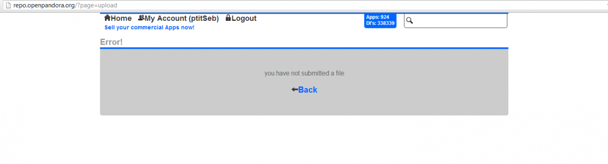

I tried uploading a new PND, GnuCASH, that is 40MB, and I had an error "application not uploaded", and it was not uploaded :(
I have this: error_uploading.png
Hm, is the file being uploaded using POST?
Then it's limited to 8MB... a normal upload is limited to 400 MB currently.
I'm not sure how to anwser. I'm using Chrome, and I can't upload where I could before. I suppose I use POST yes, I use the "Browse" and "Submit" button.
By the way, 400MB is a bit short for a few PND...
