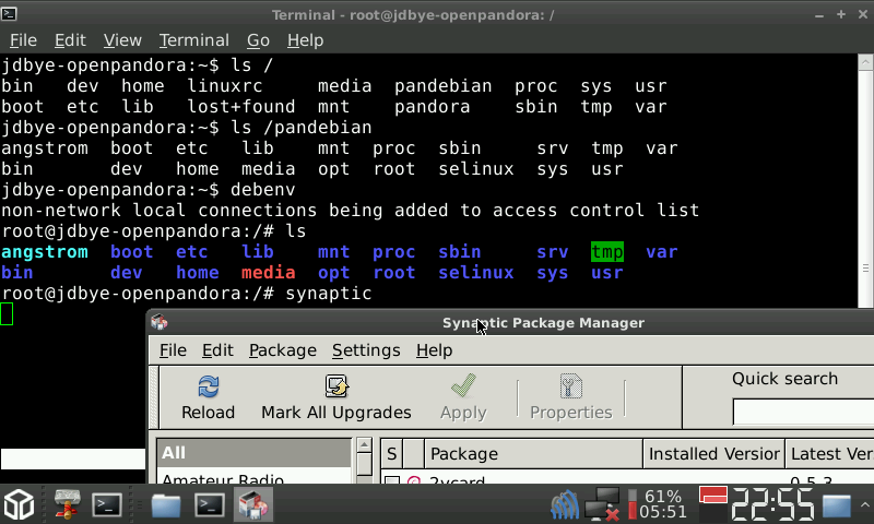

Part Three - Debian in an Extend
Technically, once the bootstrap finishes, you're done.
You could just sudo chroot /media/mmcblk1p1 and you'd be in Debian and can do as you please ( or continue down to Part Four for some tweaks, or perhaps Part Five to boot from it. )
If however, your goal is to compress this into an Extend file to use with my Extend Utils suite, and have a completely customised version of Debian to start with, continue on.
Pushing this into an Extend file is incredibly easy.

You now have a Debian install somehow, be it in an Extend or on SD card. Let's add some stuff to bring it up from a minimal system, to a usable system.
First thing you'll want to do is ensure you've chrooted into the Debian install. So do so if you haven't already.
I shall assume you're continuing on with the Debian install on your SD card.
I'll now prepend Debian to all commands we'll perform in the Debian Chroot, and Angstrom to any commands to be done in an Angstrom Terminal.
Unless you're used to messing with apt, you'll probably want Synaptic - which is a graphical front end to apt. Apt being Debian's Package Manager - opkg being Angstrom's if you're wondering.
Debian: apt-get install synaptic
This'll take up another 230MB as it installs a HUGE amount of stuff, but it should set you up for various things you might want to fiddle with, so it's all good.
Once that finishes ( and it does take a while ) you'll probably want to run it. However, as it's an X application, it needs access to Angstrom's X server, or access to it's own. Getting Debian's X server running shall be something we tackle next, but for now, we'll use Angstrom's X server.
You'll need to either open another Terminal, or go to File->Open Tab in your current Terminal. This'll be our Angstrom Terminal.
Angstrom: xhost local:localhost We're telling our X server to accept all connections on localhost - our machine - as we're about to start programs it's not aware of - our Debian applications.
Angstrom: sudo mount --rbind /tmp /media/mmcblk1p1/tmp We're doing a recursive bind of /tmp to our Debian's /tmp. This is so X apps in Debian can access our Angstrom's X authority files and such... as /tmp is in volatile space anyway, we should be fine here.
Debian: synaptic You may also want to add & to detach it from the Terminal so we can launch other things from our Debian Terminal.
You can now go and install things till your heart's content, with a rather large 21509 packages at your disposal in the standard Lenny release. There's more in Sid, and there's even more if you add the contrib repositories.
I shall stop the guide here for the moment, and shall continue with getting Debian's X server up and running alongside Angstrom's X server, and getting Debian running from a bootable SD card later on ( IE: I shall start it in a few hours and see where it takes me! )
Hopefully this is clearer than the brain dump I did on the original post!
