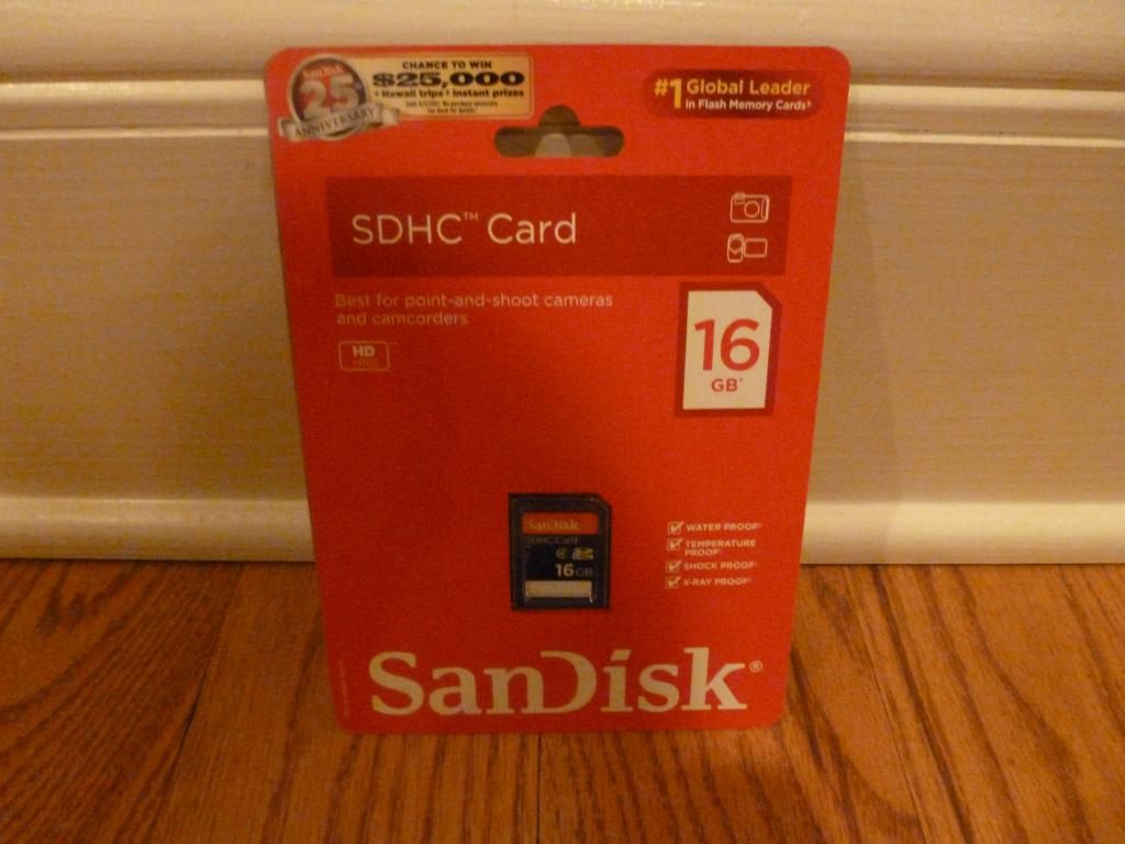

The first PNY card of mine (the okay one) is a Micro SDHC card, the other PNY card is a regular SDHC card (which caused glitches and sometimes couldn't read nor format it). The SanDisk one is of course, a Micro SDXC card (the one that corrupts my programs).

But after moving from a PNY card to a SanDisk card, I encountered problems. Should I keep the SanDisk card I have now and start all over with it, or should I send it back and buy a certain SanDisk card?
But your Sandisk is a Micro Sd not a regular SDHC card isn't it? Not many of us have tried, much less regularly used, Micro cards - so it's hard to say if that in itself is an issue. If you really want to continue using them, maybe your first step should be to get another Micro SD adapter, a different brand, and see if that helps. Any sort of connection problem in the adapter could cause corruption.

Right now, the SanDisk card cannot be returned, while its internal memory downsized itself during different kinds of formatting. The only device I have that it can be used for is my Panasonic DMC-ZS8 Lumix camera.

What else can we look at there? It says SanDisk, and if it IS a genuine SanDisk then it should be good. If you bought it from eBay or something, there's no way to know until you give it a test.
I have a couple of class 4 16Gb SanDisk cards that have never let me down, and I run the OS from a 4Gb SanDisk class 4.
Remember all the warnings about fakes out there, only buy from a reputable seller - even if buying from Amazon for example, be wary of 3rd party 'marketplace' sellers, go for a card supplied by Amazon themselves and you'll be safe.
