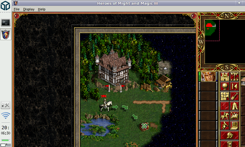

Following the advice of linuxbochs, I was able to start heroes 3 using wine 1.6, with sound. Unfortunately, the performance seems to be clearly unsufficient, the sound stutters all the time. Also, it requires 800x600 display and refuses to go fullscreen.
Update:
I made it fullscreen by faking 800x600 resolution in xorg.conf. The game is still unplayabe because army slots in the lower part of the screen are offscreen.
I wish we had xrandr working on Pandora, it would be a quick fix.

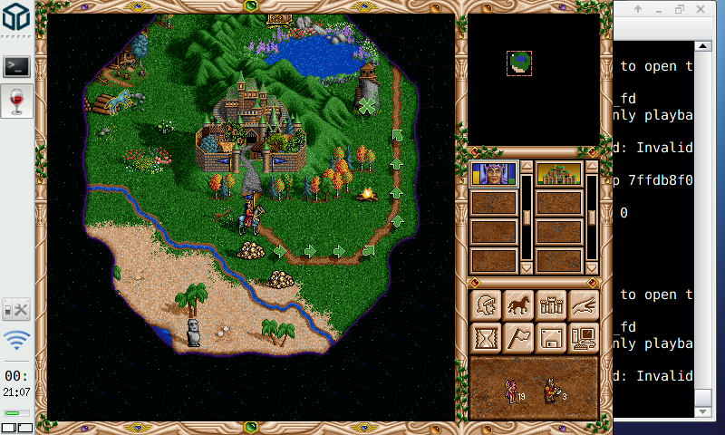

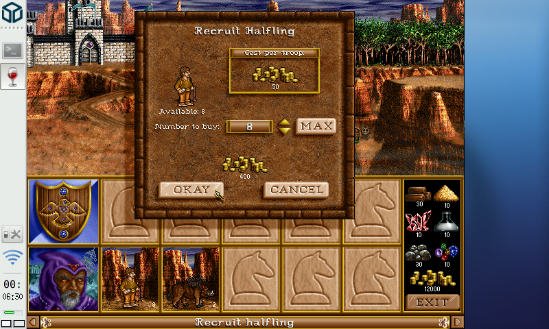

Heroes II is much better suited for Pandora with its 640x480 resolution, but the version I have found is extremely buggy, hanging up at various moments in the game. I will try the one I bought at GOG sometime later...
Thank you for your work. Heroes2 is very cool. I asked at the VCMI boards, which are part of the wog community if they know a mod which changes the resolution. There are widescreen mods as far as I know, maybe they are "small" screen mods too. About the performance, Homm3 uses software only rendering or? Did you test it on a CC, Rebirth or Gigahertz Pandora?
I have tried HD mod for Heroes3, but it requires 32-bit color for stretch feature to work, otherwise only a fixed set of resolutions (800x600 and above) is supported.
HoMM 2 and 3 use software-only rendering. The performance on my unit (1GHz running at 1.1GHz) is far from 100%, so the sound is distorted. The games themselves are turn-based, so they would remain playable with this performance. I suppose they should be playable on classic pandoras as well.

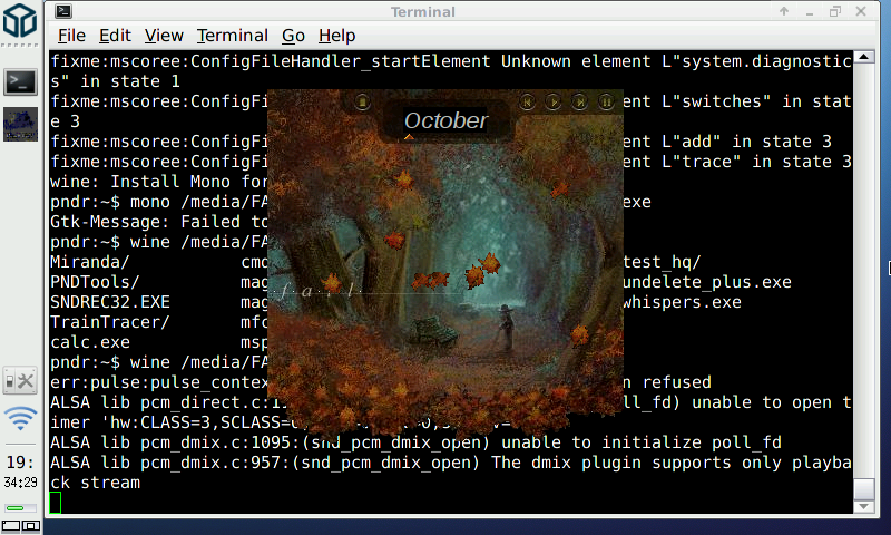

Hello all,
Today I got Razor1911 "whispers" demo working, with sound. It ran fullspeed at 1.1 GHz
Is that a mono demo (if I interpret background console text correctly)? If that's the case, x86 may not be required (I'm not familiar with this demo).
