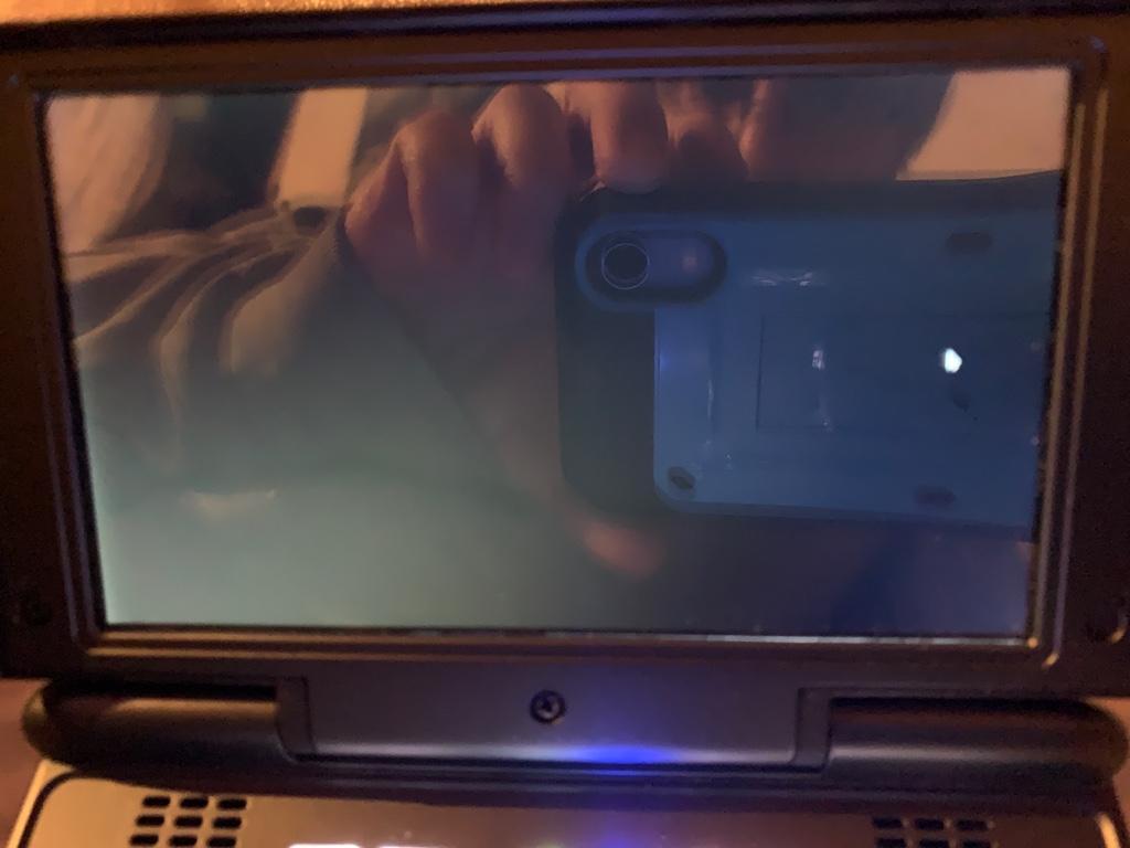

Mmmm, maybe I forgot "gl4es" (gl4es is fully integrated on my system and I don't need the wrapper, so I tend to forgot).
Post automatically merged:
Now build on the repo, a qui-repacke to use gl4es and hopefully fixing the blackscreen on start.
Build 02
  • repackaged to use gl4es
But I also allready installed GL4ES a while ago on my Pyra, you know, I also tested fu billiard and it’s dit run (Slow but steady)
What is the difference between your Pyra and our Pyra?
Yes, but my installation is different. gl4es replace mesa libs on my pyra and I don't need to use "gl4es" to use it.
Grab the updated version, it should be fixed
Also, I added the diff of this build on the 1st post.

It is crashing for me. No blank screen or anything. It just stays in the desktop.

asimov@asimov-pyra:~$
This is what I get when running from cli:
gl4es is from 1 of August 2021. That seems a bit old to me. Is your system up-to-date?
Got it working. Just did a 5 minute test and noticed that it does not list .bin images.
