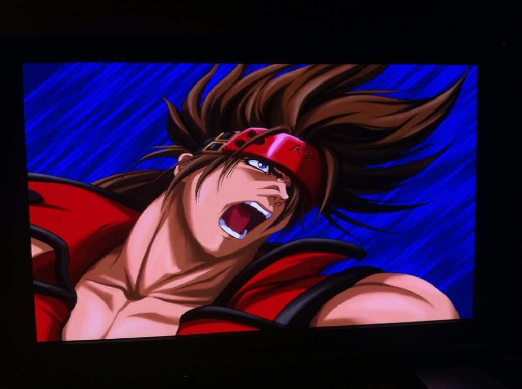

My biggest tip with the Dreamcast is to pick up a VGA Box. I run my Dreamcasts into my 52inch Plasma's 'PC input' (just a standard VGA port). The games look amazing on it.
This is a photo of my TV playing a Dreamcast game plugged in via VGA.
