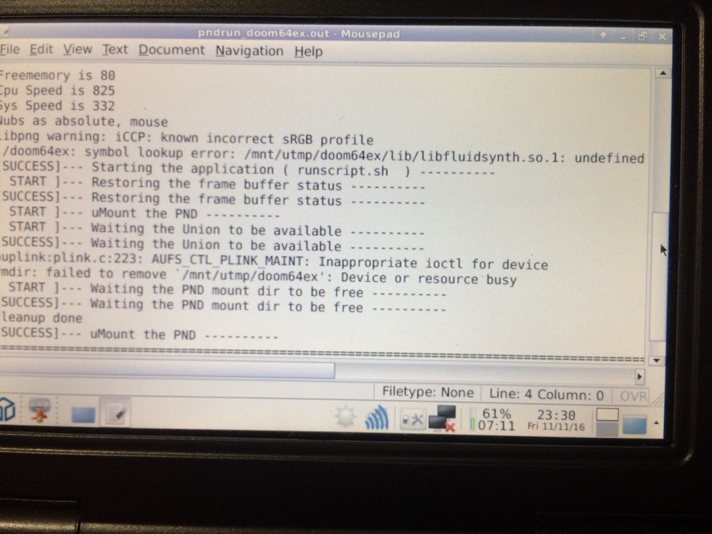

Still having trouble with doom64 but here is the read out. I have the .wad and .sf2 in Pandora/appdata/doom64ex

Ok, looks like I need to repackage the doom64ex pnd.
[doublepost=1476858915,1476855335][/doublepost]I have update the pnd @trevornot , the new one should work (and you should try some browser on the Pandora, to post text file here for example instead of pictures, there are some fast one, like Qupzilla, Palemoon or Otter :p).

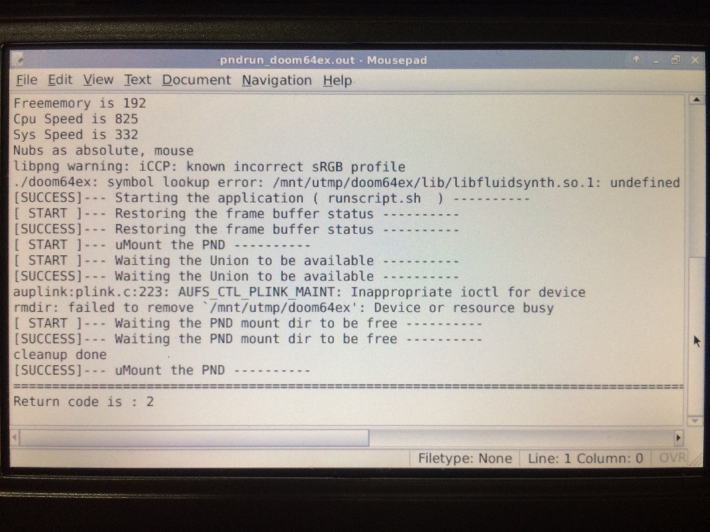

Ok so this is the current read out when I run doom64.
