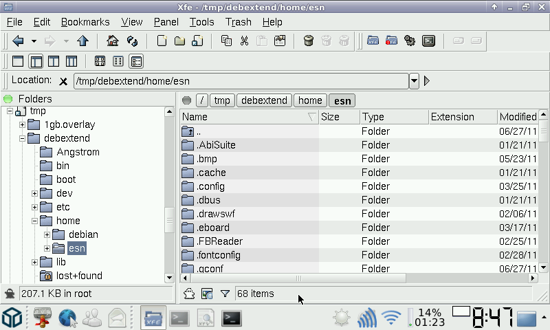

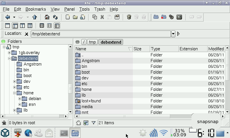

Here's what the /tmp folder looks like in Xfe:
The /tmp/debextend/home/esn folder contains what is on my NAND, not what's in the 1GB home extend. There's a .pndXmodmap file in there, for example.
I'm working under the assumption that development work should be done within the Debian terminal, not within the Angstrom terminal. But how can I do this, if I can't access any of the files I want to work on from the Debian terminal?
Stuckie said:
You can use your Home Extend without issue.. bind the Home Extend first ( and if you're still using the older Extend Utils, use "mount" to make sure it actually _is_ bound as I had issues when I was testing with it and it didn't always take, ) then run the Debian Extend so that when it binds to your home folder, it binds to the right one ;) Else it can be sneaky and bind to NAND instead as I found out!
Yep, that's what's been happening. It has been binding to the NAND. Maybe FAT32 is causing the problem? Maybe I should I try putting everything onto an SD card formatted to ext2...
I've been using a FAT32 card to test this all with, so that's not the problem.
To be honest, I have no idea what the problem is :(
Especially as it looks like your home folder is bound out as /home/esn in the screenshot there, and since it's an rbind mount, it should be exactly what you see in Angstrom.
And I forgot to grab the Pandora on my way out, so I can't test anything till I get back.
In case it helps figure out what's going on, here are a few more things.
Screenshot of the contents of /tmp/debextend/home/esn in Xfe:

Here are two screenshots from Xfe, one of the /tmp/1gb.overlay folder, one of the /tmp/debextend/home/esn folder. Note the absence of any "uqm" files from the latter, along with any other files that are present in the first location...
http://i.imgur.com/9Vv0s.png
http://i.imgur.com/5Ib18.png
Seems like the "mount" command tells one story, and reality tells another.

You can open a file manager (for example Thunar, or Xfe) and verify that everything is as it should be. Here's how it should look:
1. The contents of "/home" and "/tmp/1gb.overlay" should be almost identical
2. The contents of the following three directories should be identical:
/home/username
/tmp/debextend/home/username
/tmp/1gb.overlay/username
