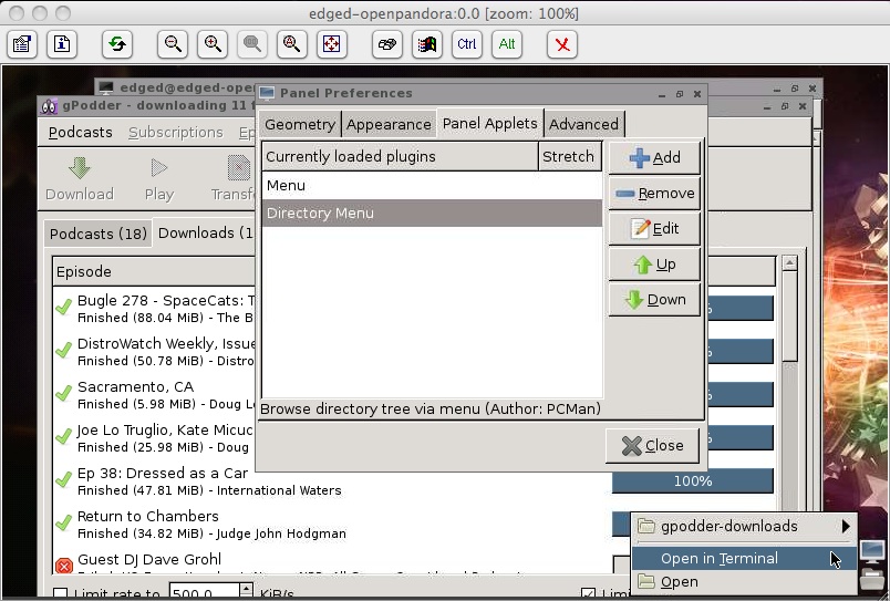

While I haven't exactly found a fix, I have found something that might get you to a place where you are more comfortable error-correcting.
When you install PanDebian and it gives you only the "Run" and "Logout" options, the "Run" option immediately shuts down Pandebian. It seems like there is no way to get a terminal open. However, there is in fact a quick way to access your terminal:
1. Right-click on the PanDebian menu icon.
2. Select "Create New Panel".
3. Right click on the newly created panel and select "Add/Remove Panel Item"
4. Click "Add", and select "Directory Menu" and then select "Add" again.
5. Click "Close"
6. Left-click on the newly created "Directory Menu" icon and select "Open In Terminal"
You should now have a terminal open. From here, you can su -> synaptic to add/remove programs. Programs can all be launched from the terminal.
I haven't figured out why the menu is broken, but I will keep on it and let you know if I figure out what is going on. I don't think I have changed anything since the last time I installed PanDebian. It is possible that I am running PanDebian installer from an SD card that is formatted differently than before, but that is all I can think of. I have an older firmware installed to an SD card, so I will try installing from there, perhaps.
Edit:
I just realized you don't need to create a new panel. You can just edit the current lxpanel to be wide/tall enough to accommodate adding the "Directory Menu" plugin. I also moved the panel to the bottom right in the below photo:
