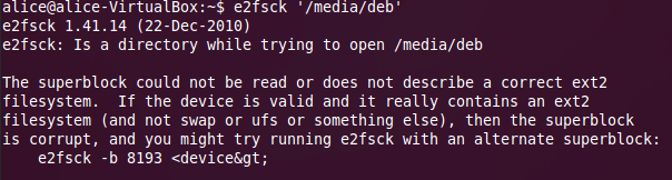

Had the same problem as zeldarocks - ran e2fsck on the card and got this.

You've tried to fsck the mount point rather than the raw partition, which'll be /dev/mmcblk0p1 for example ( for first partition, left slot ) .. not sure you can fsck mount points, as I've never really done it..
Also, make sure it's unmounted before attempting that... fscking a mounted filesystem is bad.
