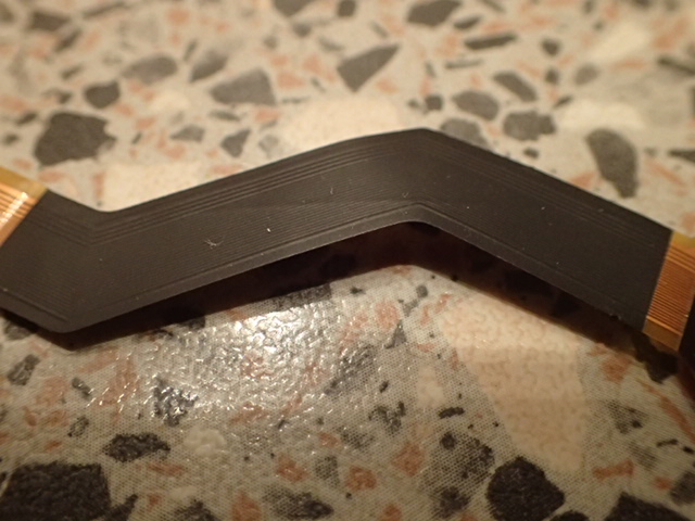

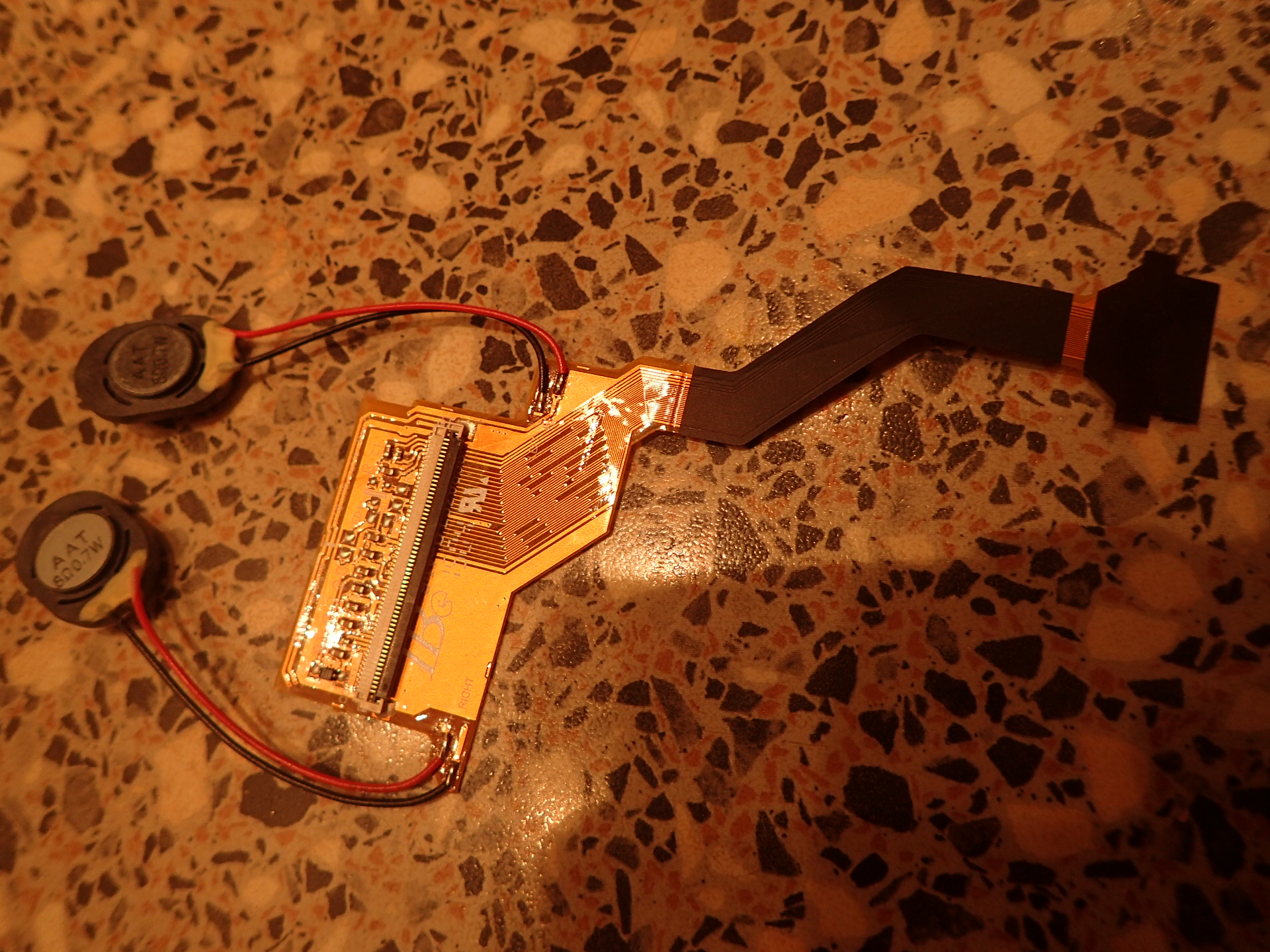

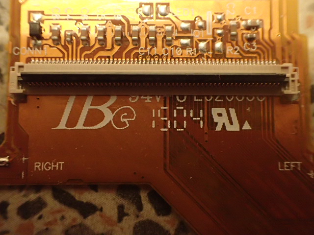

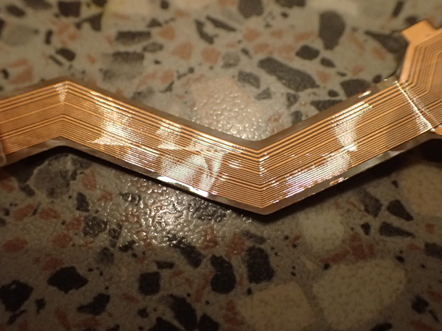

I did finally remember that ED did give me a broken Pandora before we started the Pyra project years ago. After searching some hours I have found it and so I have one cable for physical reference. It has a silver coating at some places. What is the difference to the "black" one?
The black layer is a sort of solid plastic.
When you bend the ribbon and release it, it comes back flat.
They were made in Japan if I remember right.
Here's some pictures:
When you bend the ribbon and release it, it come back flat.
Ok, I see. Thanks for the pictures. Well, adding that is beyond what I had in mind...
So they will probably be neither silver nor black. It also looks as if the PCB design has changed.
If the black coating is necessary or not - I don't know... It may help to wind the cable or avoid abrasion.
The Gerber data I have got are obviously for the newer (black) version. So they are already the improved design variant (speaker solder points separated on the left and right side).
