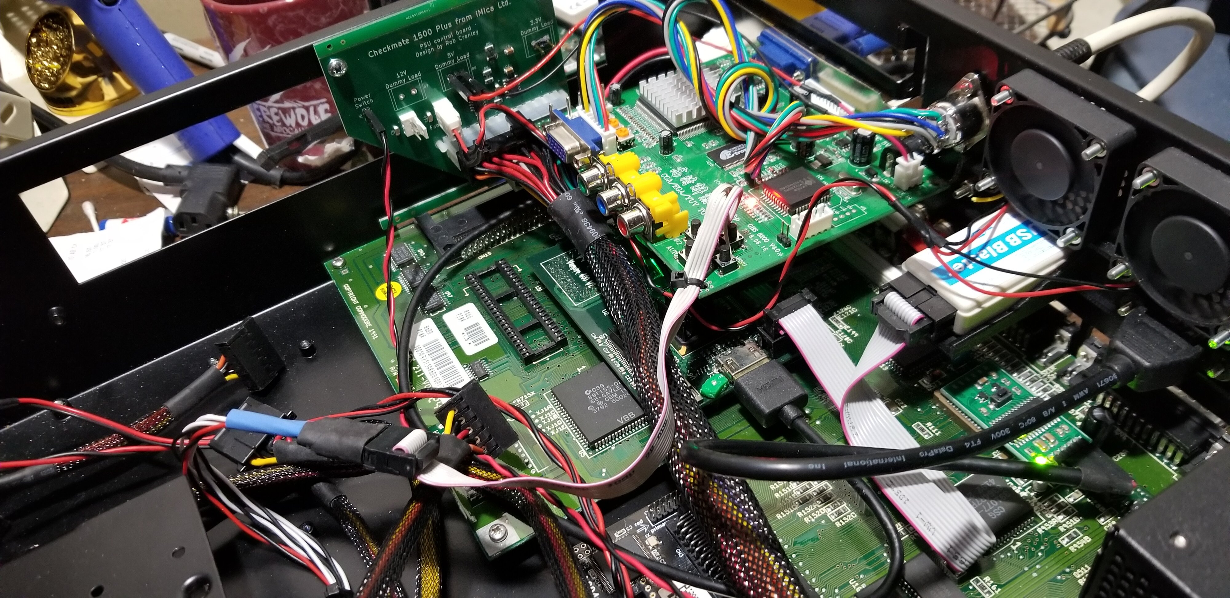

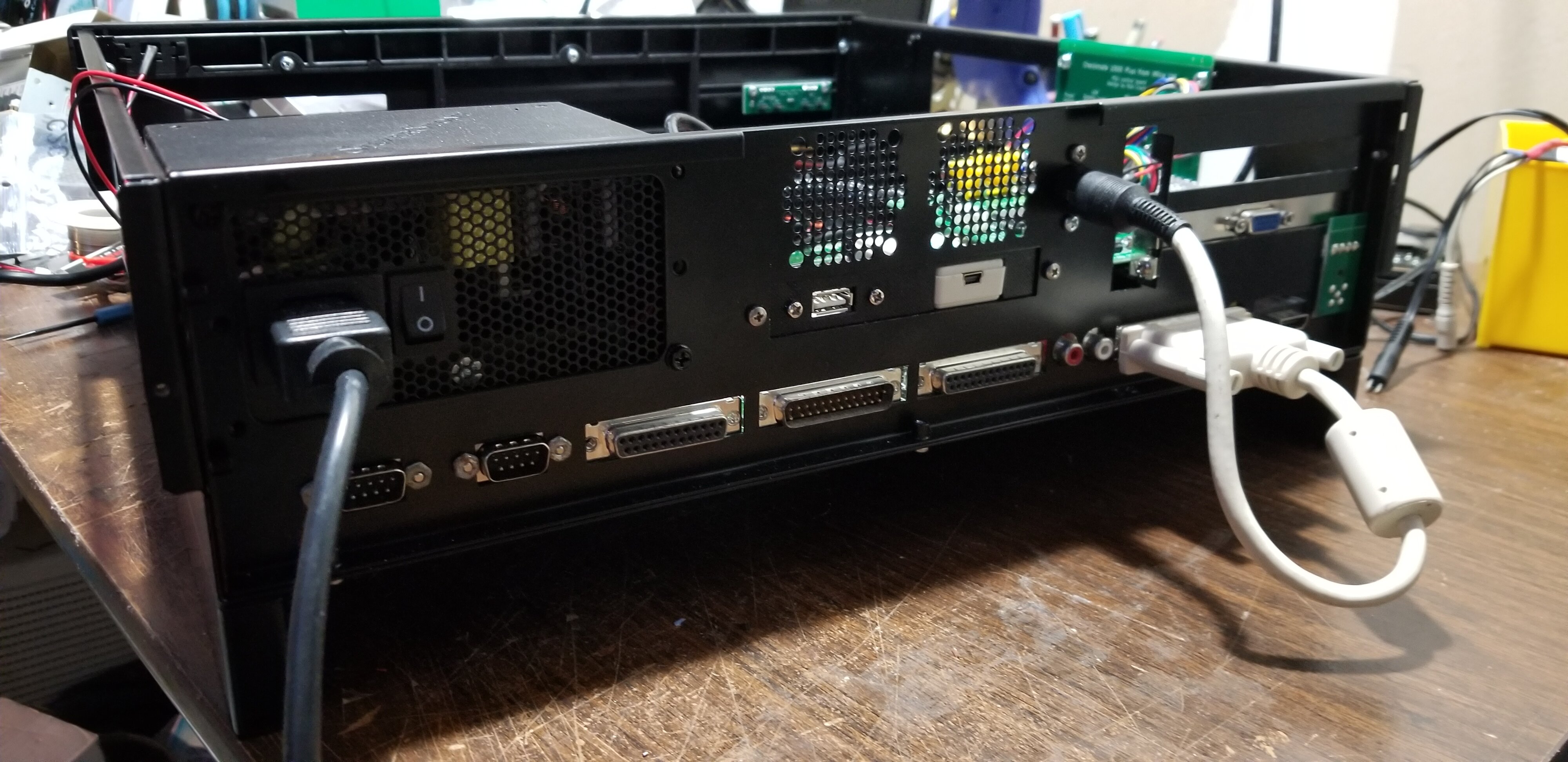

Finally got to finish my CheckMate A1500 build with my A600 as I got the back panel and power supply converter. I eventually want to get the OMAP5 Devboard in there, but I need to think through a few problems with doing so.
For switching the A600 into a desktop I needed to get a SUMs USB keyboard adapter Fits over the U7 chip, which I believe acts as the CIA chips in other Amigas.
http://amigaonthelake.com/the-sum-a600-keyboard-adapter/
I 3D printed a bracket for the USB keyboard port and decided to add a place to hold a USB Blaster used to program the Vampire if the normal method doesn't work or program alpha/experimental cores that are sometimes released.

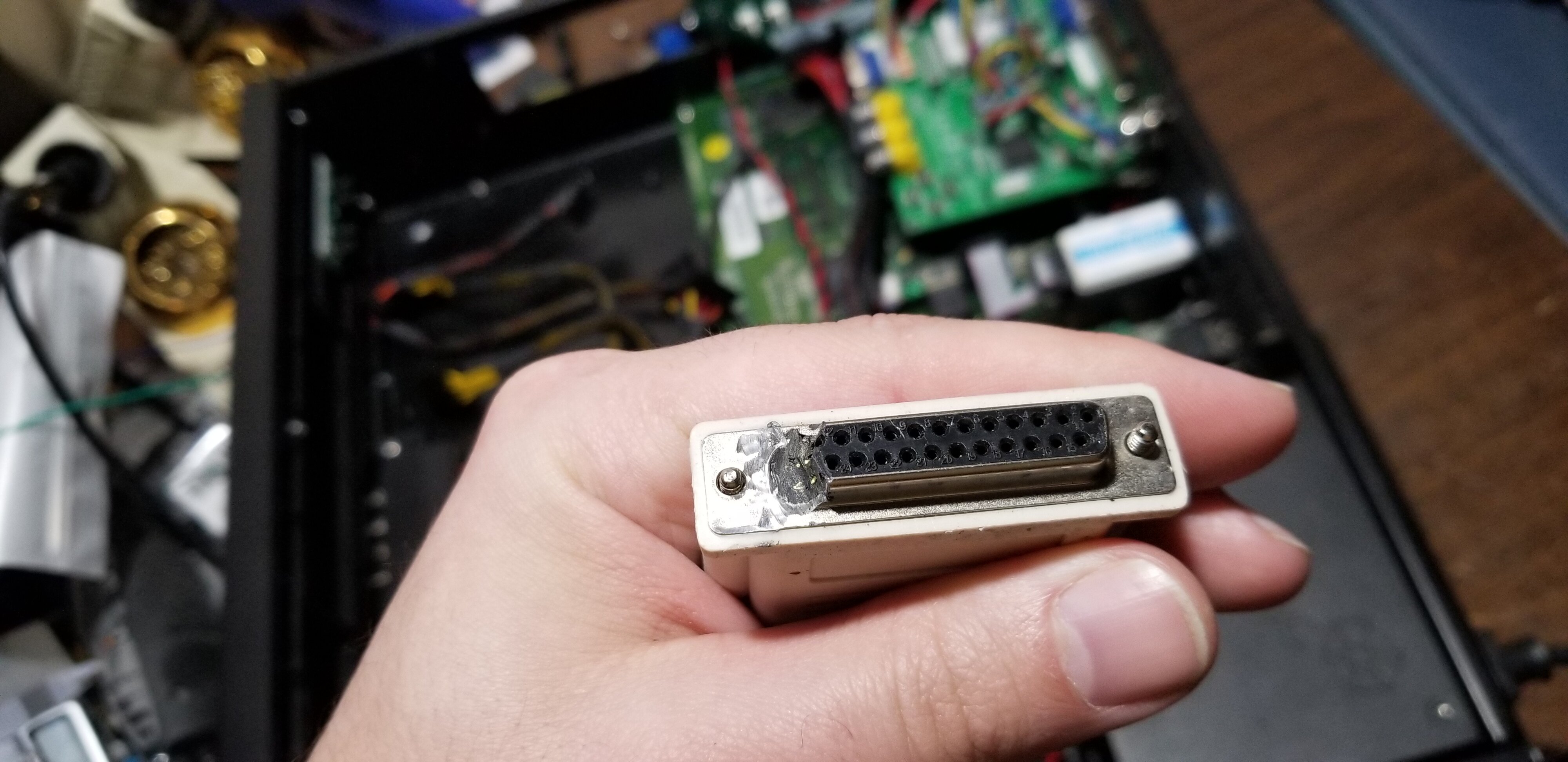

I'm using a GBS 8200 Video to VGA adapter scalar/converter board, I fitted an old PC expansion slot to the VGA output connector and it works perfect to hold it in place. I needed to make a special video input as the RGB is coming from the DB-23 Video output, I hacked up an old DB-25 cable and shaved it down with a rotary tool, fitted a 5-pin DIN to pass the RGB/Sync connections into the input of the GBS 8200's internal connector. Not quite the most elegant solution, but I figured it was better than trying to fish a cable through an expansion slot as there was a DIN connector hole in the back panel already for an optional keyboard connector with the checkmate case. I've also created buttons for the GBS 8200 in the front, with a quick disconnect.
Outside some custom wiring needed for the LEDs and such, bought some DB-9 panel mount extenders to have the two joystick/mouse ports that are on the side of the board to the back like an A500/A1200 has it. I think it came out alright.

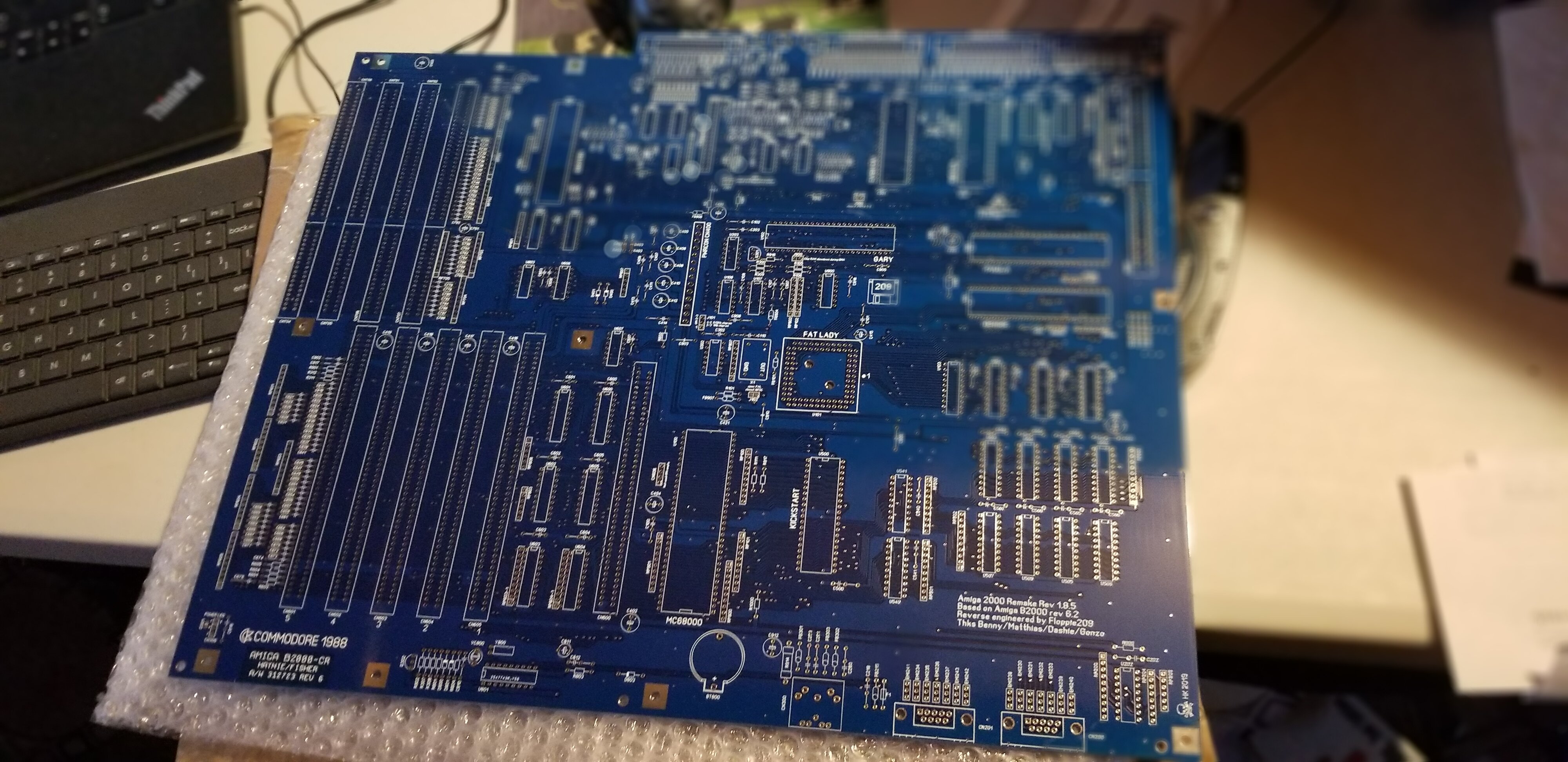

Next big project...
Going to populate this board to essentially make a new (outside original Amiga Chipsets) Amiga 2000.
This is a brand new Motherboard for an Amiga 2000, I ordered a ton of components Resistors, Caps, IC sockets, and etc, even new old stock DRAM.
It's essentially going to be a stress relieving soldering project that will take me a while to finish.
It's an open-sourced replica Sources here: https://github.com/Floppie209/Amiga2000-remake
I just bought the board off ebay...

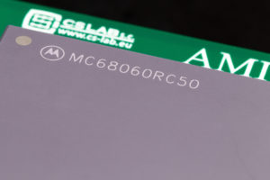

About the Warp1260, yeah it's a pretty good alternative and almost as fast as the V1200 as it uses an ARM processor to do some of the heavy lifting, But from what I understand is you need to source your own MC68060 processor and it's getting harder and more expensive to get those. I was considering the Warp 560 for my A2000, but I'm not sure I can trust getting The MC68060 off ebay from China and not sure I've found any legit stores still selling them.
