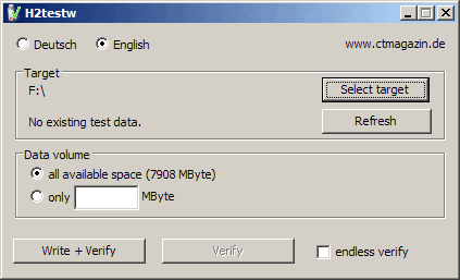

4: Run H2testw. You'll see a window that looks like this;
The default language for this app is German, since it was commissioned by a German magazine. However, it has a radio button to switch it to English. Once you've set which language you want to use, click on the "Select Target" button and navigate to the SD Card that you plugged in during step 3.
5: Once you've made sure that you've selected the correct target, check that the radio button for "All available space" is checked (the space on the card will be displayed in brackets after "All available space"). After this, click on the "Write + Verify" button.

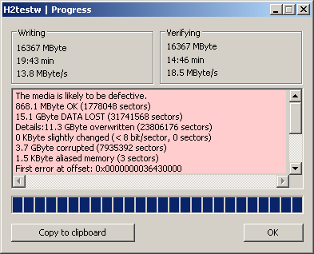

7: When the test completes, you should see something a little bit like this;
This screenshot shows bad test results from a fake card. If your results look like this, this is why you're having a problem. Most likely, however, your results will not look quite like this, and they will tell you that the card is ok. What we are interested in here is how much memory H2testw determined was fine, excluding reasonable formatting overheads - this will tell us how good the flash memory chip in the card is. For example, a 2GB card with a good Grade A flash memory chip, formatted as FAT32, will have 1.9GB of usable space. If it is a Grade B chip, this would be 1.8GB, or even 1.7GB or lower.
