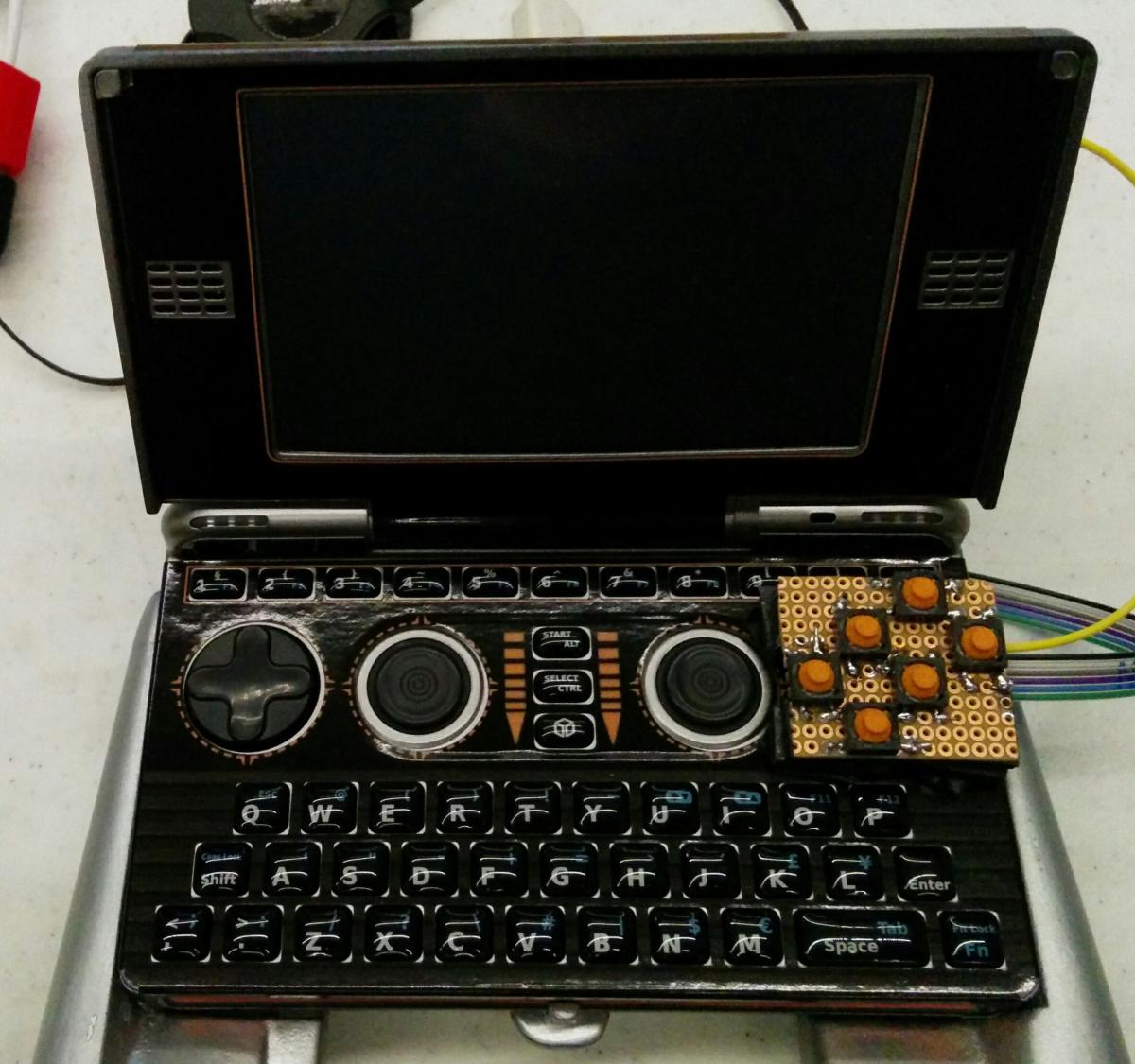

While reading the Pyra threads about 6 buttons, I decided I would see if I could mod my Pandora to have 6 buttons. I figured I would test if the 6 buttons would really be too close to be useable so I programmed my Arduino Leonardo as a USB joystick and wired up 6 buttons as close as I could get them. Here is what I ended up with.

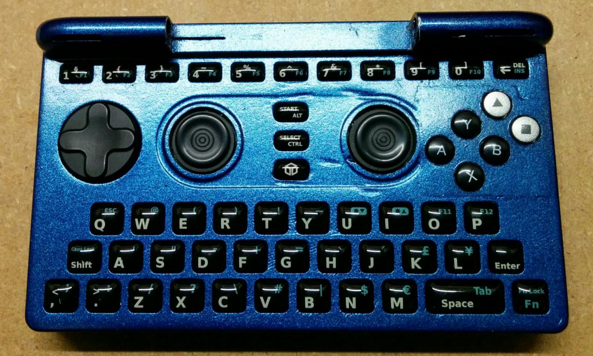

The buttons are useable but since this is just sitting on top of the Pandora, it is too tall and blocks the keyboard keys as well as the right nub. The buttons worked good enough that I decided to mod my extra Pandora case. I have not completed the insides yet and I definately could have spent a little more time on the outside but here ise how it looks for now.
I decided that I am going to try to build a complete replacement board for the Pandora so that the keyboard works as well. I figured I would replace the nubs with the nubs from a PSP or maybe just use the joysticks from one of my broken PS2 controllers.
