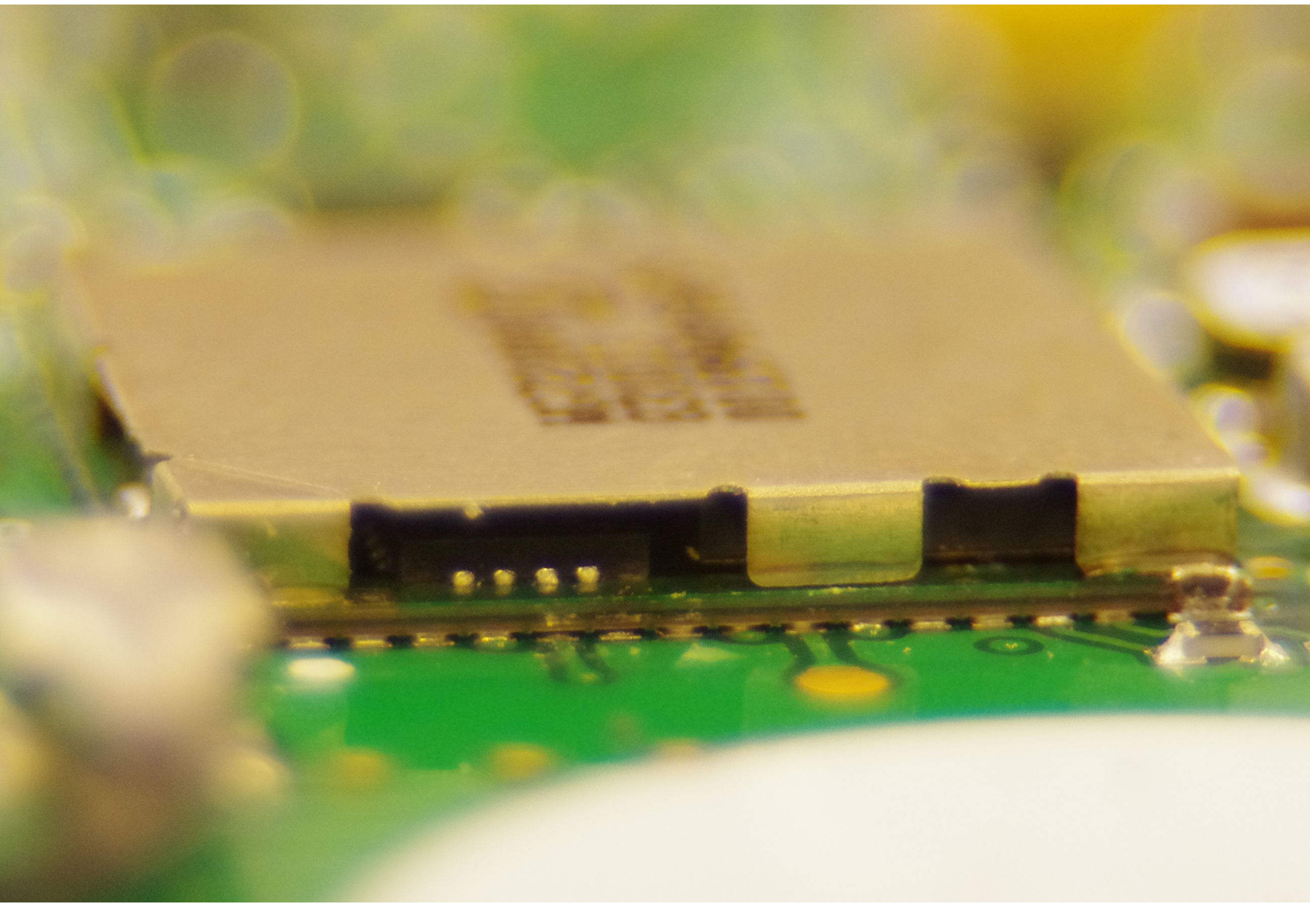

The biggest problem is that the Wifi only works twice during last couple weeks. It
simple won't come on. No red LED even if I choose togle Wifi program or executed
the op_wifi.sh manually. I saw red LED coming on when it works twice. However, no
lack since then.
I tried the old and new driver. However, it seems those driver fix is not working
with my Wifi module.
After trying for couple weeks, I finally decided to inspect the board.
I checked the board and I am now suspecting the connection between the board and the
Wifi module.
I attached the dmesg log after running the op_wifi.sh and the close up pic of the
Wifi module. Number of pins on this edge looks like are not well connected. Some of
them looks like is not connected well, but are connected as you can see. However,
two pins a bit left from the center of the image looks not connected or at least
only half connected.
Any suggestion?
