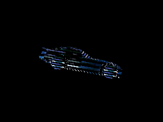

I have tried porting Vincent OpenGL-ES to the GP2X, and have had some success.
The Dodge Viper from the example code supplied with Vincent.
It runs quite slowly (I'd guess at about 3-4fps), the texturing is not right, and the original code is the most horrid abuse of C++ I have ever seen. If I was to do OpenGL-ES properly on the GP2X, I would start from scratch in plain C.

The port so far is just a "get it compiling and see if it runs" effort. It has been a two day effort. It does not use the 940T, nor does it use the 2D graphic accelerator.
andrew j w seems to be a lot further ahead with his own implementation. It will be nice to see that in action.
