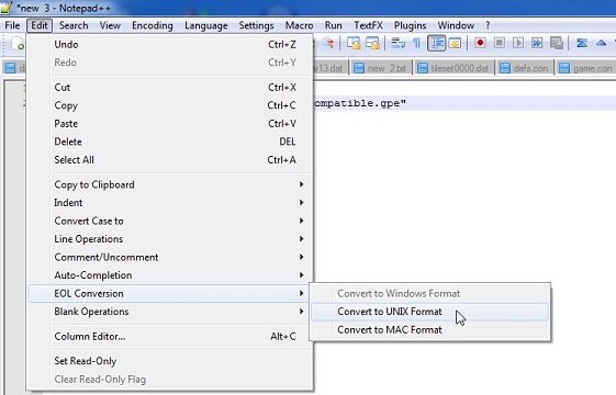

I think you should use Notepad++ instead of notepad.
Try to convert to Unix end of line format and then save the file.
tried that and it works now.
