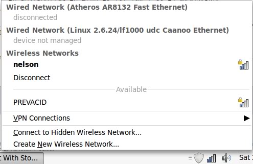

ok, may need a little help here.
It appears as a Network device - [Unknown Interface (usb0)]
I assume I need to bridge it to my eth1 which is my internet connection.
Based on your IP configuration 10.0.2.2, I am assuming your routers address is 10.0.1.x.
so in my case my router is at 192.168.1.x so I changed the ip in the gpe file to 192.168.2.2 and tried to bridge eth1 to [Unknown Interface (usb0)] and it will not work.
Is there a way to do this with out installing a DHCP server on my laptop.
I also tried firestarter
Sorry not much experience with networking, thanks

I've gone through the instructions, but, for some reason, my Linux laptop will recognize it, attempt to connect, and it fails each time, and displays a notification that the connection has disconnected.
Here's my network_interfaces file:
Code:
allow-hotplug usb0
mapping hotplug
script grep
map usb0
iface usb0 inet static
address 192.168.1.64
netmask 255.255.255.0
up iptables -t nat -A POSTROUTING -o eth0 -s 192.168.1.99 -j MASQUERADE
up echo 1 > /proc/sys/net/ipv4/ip_forward
down iptables -t nat -D POSTROUTING -o eth0 -s 192.168.1.99 -j MASQUERADE
down echo 0 > /proc/sys/net/ipv4/ip_forward
192.168.1.64 is my laptop's IP address, and 192.168.1.99 is what I want my Caanoo's address to be. Is that right?
EDIT:
Okay, after upgrading my Caanoo's firmware from 1.50 to 1.60, it still shows up in my network manager, but doesn't try to connect:
