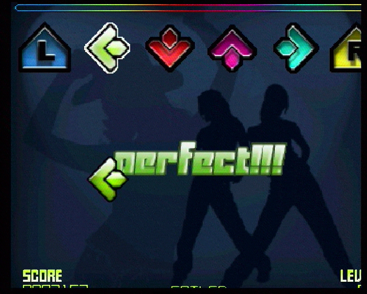

I just purchased my TV-OUT cable for the GP2X.
It does it's job, but for example on Beat2x it cuts out the right and bottom of the screen:
Positioning in firmware does not change anything, even if I move it all the way to the left the rightmost of the screen is cut off.
Is there any known way to fix this or do I have to live with not being able to see the R-trigger completely?
I had that happen with CACK. It seems to be caused by using hardware sdl surfaces with double buffering. Switching to software surfaces or a single hardware surface solved the problem from what I remember.
Burbruee said:
I HAVE COME TO HIJACK THIS THREAD! :ph34r:
Also, here's a comparsion between PAL and NTSC output.
As you can see, NTSC makes the text in the firmware hard to read.
Like woogal said, it's driver pb, a partial solution can be to change the TV surface resolution but this solution need to be included in the program itself. I've already included this methode in my programs because I've a plasma TV and the original scalling is awful.
