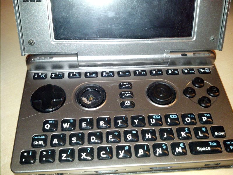

This is how much I hate the nubs on my Pandora
It is not hard to desolder nubs. You need a desoldering tool if you are not experienced. I only used my soldering tool to desolder my bad nubs. The removed bad nubs are still good shapewise.

My left nub has some hardcore plastic cracks underneath, I might need to get some superglue onto it. probably why it doesn't work properly
My left nub seems to work okay some of the time, but my right nub seems to have a spot on the bottom left that doesn't register, so my Nub Test sort of looks like a cookie with a bite taken out of it on the bottom left side. I'm going to wait until I can snag a 1ghz board though, and I'll replace it and then see about 3d printing a separate case for my Rebirth for use as a mini desktop or something.
Have you tried your luck with superglue already?
I would be careful and try some other kind of glue. Superglue (cyanoacrylate) emits fumes that might settle on surrounding surfaces and render contacts non-conductive.

Changing them was not easy and I struggled a lot with removing the solder.
Luckily, there was an easier way to remove the nubs (in case anyone else wants to replace them). It was possible to squeeze a piece of paper between the PCB and the nub. Instead of removing the solder, I applied more. This ensured that holding the soldering iron onto a soldering joint would melt all of the solder of that joint (between the PCB and the nub). Then I moved the paper into the solder joint and removed the soldering iron. This separated the nub from the PCB in that spot. After five repetitions, the nub came loose  :)
cool idea with the paper. usually you could have used a desolder pump, if you don't have one, they are really cheap (like 3 or 4 euros if you get a budget one) and very handy for simple desolder jobs like this.
