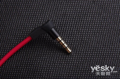

Although I use a bended
plug (so it does not get in the way of fitting on my chest or pocket), it goes over the power switch, which becomes hard to reach. Also, maybe put it on the right side, so it also is next to the volume knob. BUT ONLY IF it does not degrade audio quality. Also, maybe swap the microphone to a place where recording audio does not sound that crappy with digital noise.
