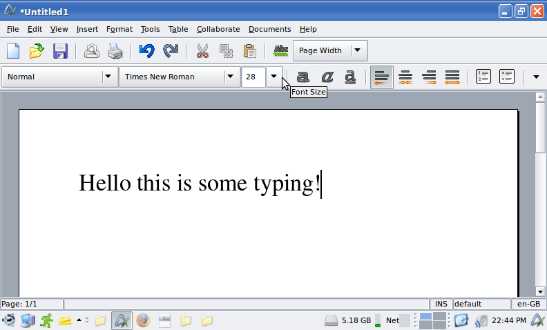

Here's one I made earlier:
The iconset is called Gnome XP.
