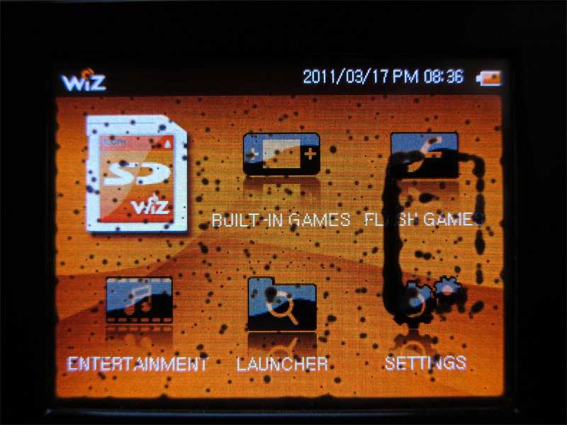

I just got my new Wiz and the same pattern dying pixels on it. It's kind of unfair since I practically haven't used it yet...
rsuryase said:
Organic really means organic, the dead pixels is spreading like cancerous cells.

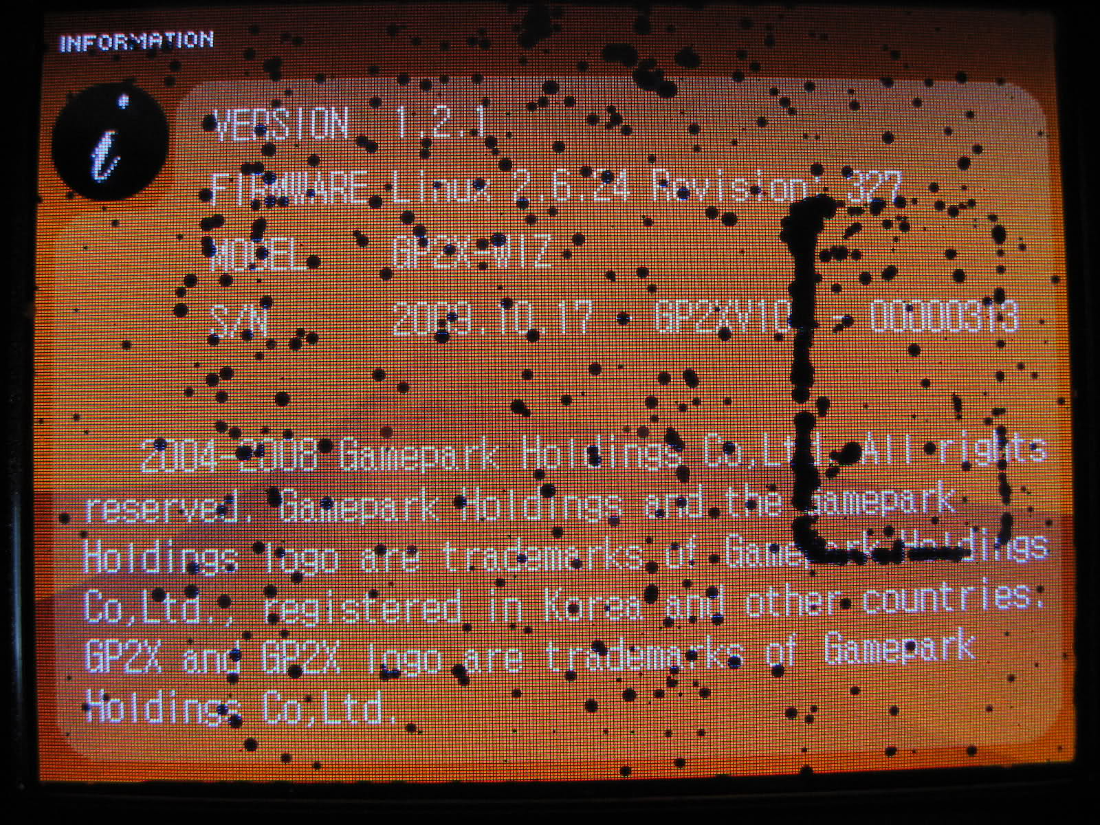

Having seen a few of these failed displays: the blob area to the right remarkably reminds me of the "battery low" imagery. And it reminds me of the OLED burn-in syndrome too.

That "blob" is some kind of sticker thing on the back of the screen. I think the screen is de-laminating causing this.
It is not at all like burn-in. With burn-in you see a ghost of a static screen burned in with some colors, or an area that the color shifts to the yellow a bit. No burn-in has these pure black blobs.
Sphinxter said:
Looka lot like contamination during manufacture to me.
No, because many of these screens work fine for months. Then they get the "pixel plague" and die. Plus someone took a picture of the a bad screen outside of the unit. It had some kind of sticker where that rectangular blob is. That indicates that there was slightly more stress there from the sticker adhesive causing it to delaminate a little more there. If they were contaminated from the beginning they would be bad right away and the pattern wouldn't be the same every time and just coincide with the sticker shape in that exact area.
Contamination in the lcd manufacturing process will not show right away as it take months to oxidize.
