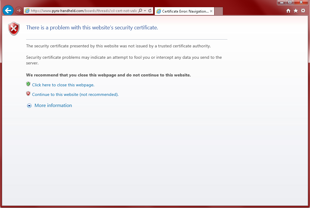

    Seeing you're on windows, do you also get this issue when you open it in internet explorer?
    I suspect the issue might be with people having outdated CA certificates installed.
    I tried opening it in the built-in browser on my old Galaxy SII, and I also get an error. It's running KitKat 4.4. With the latest version of Firefox, it works fine because Firefox ships its own certificate store.

    Yeah happens in IE too!

    As other mentioned Firefox uses it's own list of trusted CA and TLS library. (for Desktop and also Android it seems but not IOS)
    The error indicate the root CA 'DigiCert Global Root G2' is not trusted (not installed on system...)
    The certificate for this website require this CA. There is no alternative trust path. (I checked)
    To be sure the issue is indeed the missing CA, can people having issue try to open:
    https://global-root-g2.chain-demos.digicert.com/
    If you get an error on this digicert test page it confirm the root CA 'DigiCert Global Root G2' is missing from your system.

    When renewing your certificate did you have to chose between 'SHA-1 root CA' and 'SHA-2 root CA' ?
    If that was the case, maybe the SHA2 root option is less compatible (I am unsure, if it is it's not due to SHA2 itself as android 4 supports it).
    To be sure the cause is missing root CA can people having issue try to open:
    (A TLS error on this digicert test page mean the root CA 'DigiCert Global Root G2' is not trusted on your system)
    Let's wait for confirmation first but you could consider using Letsencrypt as they now offer wildcard certificate. (free of course)
    That is if it turned out to be more compatible that you current cert: https://letsencrypt.org/docs/certificate-compatibility/

    @the_marshal thanks for the explanations! I can confirm, that both test links result in the same SSL error.

    Nope, it was simply reissued using the same key and request from last year (to prevent that "all Symantec certificates will become invalid by Chrome".

    Thanks for the confirmation. Last (official) android for droid 4 appear to be Android 4.1. Are you running that ?
    You do realize you're not getting security update on such an old device, right ? (don't get me started on Android update and manufacturer. It's a mess)
    You should be able to manually install the root CA on your device. 'DigiCert Global CA G2' from https://www.digicert.com/digicert-root-certificates.htm
    It's not something you normally should or have to do...
    Yes they *just* started (still early days): https://letsencrypt.org/2017/07/06/wildcard-certificates-coming-jan-2018.html
    It seems to me like nothing is wrong with your webserver config or SSL certificate. Also renewing the cert was the logical thing to do.
    Your new certificate uses a different root CA. Why it is missing from some device I don't know. (did not find much on Google)
    The CA itself exists for a long time but it appear like it only started getting used to issue cert fairly recently. (which might explain why it might have been missing and nobody noticed)
