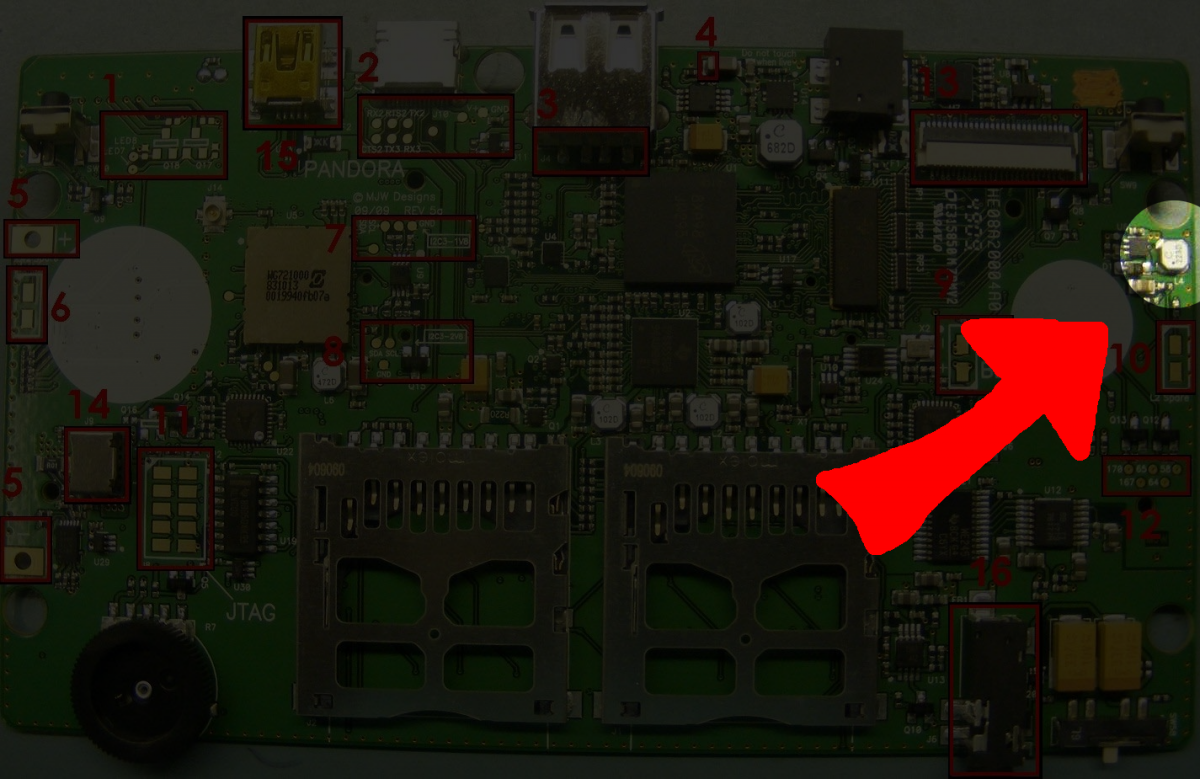

Mine unglued from the Pandora while I was fixing the right shoulder button.
I downloaded the schematics, but I cannot figure it out what does it do. And I didn't put the battery back, because I need to know how important 223F is (making me unable to play T_T).
And most of the components are hard to work with with an iron solder. I'm tempted to acquire a hot gun like this.
That's a coil needed for the backlight of the display. Until it's resoldered, you'll have a dark screen.

How easy is it to knock the coil off?
Is there a way to prevent it from coming off the board?
Why do they keep falling off?
It's pretty sturdy normally, but it seems there was a batch of bad coils that easily break.
