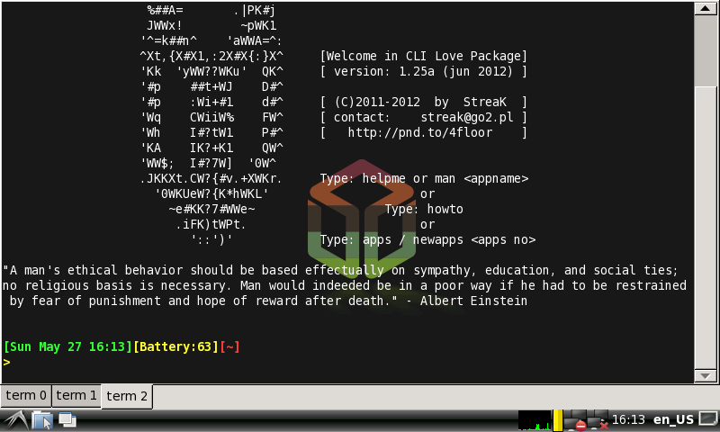

There was a batt command. I added it to prompt command line in StreaK's CLI Love Package, so you can monitor battery constantly
screen:
http://repo.openpandora.org/?page=detail&app=cli-love-app
