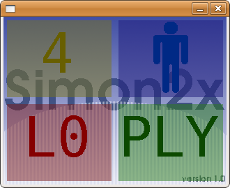

I released a game I've been writing the last couple weeks: Simon2X.
Enjoy!
