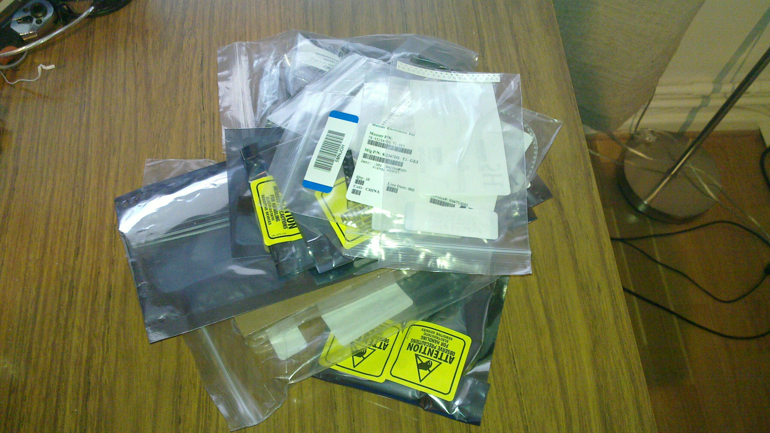

A pile of parts for the prototypes arrived. Mouser ships fast, and Fedex sure seemed to be in a hurry to deliver :P
Now only waiting for the PCB's (shipped today), stencils (ordered today) and solderpaste (ordered today.)
Sometimes, not everything goes to plan. Especially when you don't have the components in front of you while designing.
We somehow managed to get the SD card slot backwards, so that's no good.
And the bought the wrong resistor networks, they're about half the length of the ones we needed!
Can we get anything to work at all with these boards? To be continued.. :x
