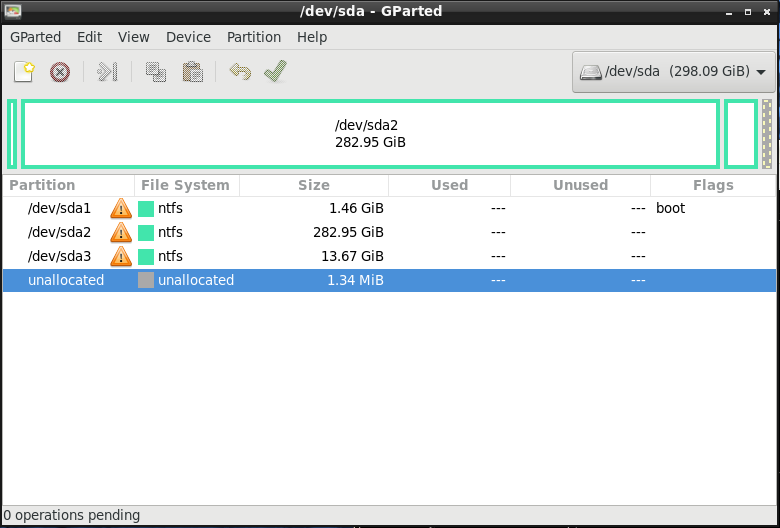

I restored the MBR earlier and the partitions look right. Used "partprobe" on the first try, but had rebooted before the second try. There should really have been a backup of the whole unallocated 1MiB at the start of the drive, but I imagine missing that would only break the bootloader, not the whole lot, right?
There appears to be something recognizable as NTFS in the partitions afterwards, so I guess I'm not doing completely the wrong thing.

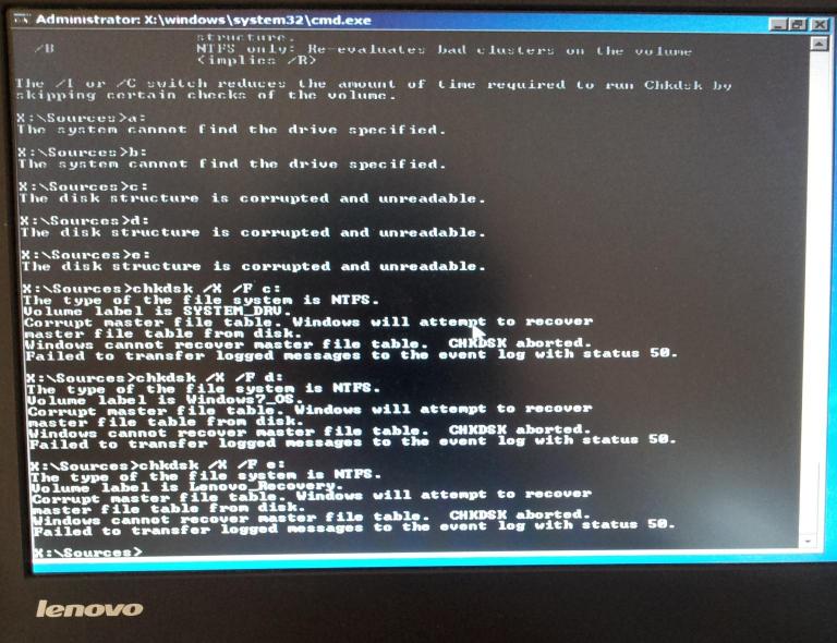

"mount" told me to run chkdsk from Windows, so I booted a Windows DVD to try that, but it couldn't fix it.

[liveuser@localhost]$ sudo fdisk -l /dev/sda
Disk /dev/sda: 298.1 GiB, 320072933376 bytes, 625142448 sectors
Units: sectors of 1 * 512 = 512 bytes
Sector size (logical/physical): 512 bytes / 4096 bytes
I/O size (minimum/optimal): 4096 bytes / 4096 bytes
Disklabel type: dos
Disk identifier: 0x6479a0bb
Device     Boot     Start       End   Sectors  Size Id Type
/dev/sda1  *         2048   3074047   3072000  1.5G  7 HPFS/NTFS/exFAT
/dev/sda2         3074048 596467711 593393664  283G  7 HPFS/NTFS/exFAT
/dev/sda3       596467712 625139711  28672000 13.7G  7 HPFS/NTFS/exFAT

The computer still needed a repair from the Windows DVD to make it boot (and I was too impatient and tried several things at once, so I don't know which one was needed).
