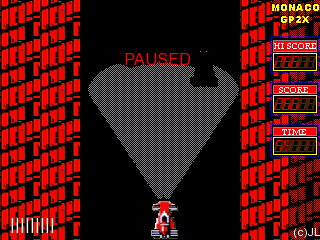

The only thing is i'm not sure how to fully implement the head light yet. The headlight will show only what's within it... i.e. part of the enemy car....
One possible solution would be to make a mask using the headlight effect graphic and draw that 2nd last.
So you would draw everything as normal then blit the headlight effect over everything, then the players car. You would need a pretty big mask bitmap but just blit the bit you need from that.

ahh right... I think I get you here. I'll have a bash with this in the morning.

There is a new build up now which has got the headlight on when in the tunnel... The program checks what tile is in front of the road and if it's XX then it puts on the headlight.

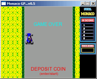

I've put the latest version up. Done a simple menu screen like the arcade, hit start/enter to begin. My final 2 tasks will be a game timer and making the ai dart in various directions.... Unfortunately I've had to drop any transparency effects It kept drowing out the cpu on the gp2x...
