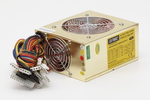

I currently own a 650 watt QTEC psu. I know that most people don't like the brand (yes it's (probably) over rated) but it was not expensive and still delivers voltages well within the ATX tolerance limits. I've owned this psu for 1.5 years (still functional) now but I am starting to get irritated by the noise it generates. So my plan is to replace the 3(!) default fans with temperature controlled ones.
My question is whether this is wise? Would the new fans cool the psu sufficiently?
Please don't say buy a different psu. The psu works fine, and a new one is quite expensive.
Thanks for the feedback!

It's a QTEC. a 650W QTEC is equivalent to a 300W decent make PSU. Or, as one review put it, "Capable of 50% of it's claimed power at 60% efficiency, but switched itself off when we requested 75% of the claimed power. Should be left rusting on the shelf."
I'm not going to repeat the part where they talk about the voltage rails leaping up and down by 20%, and the fact that it later tripped one of the circuit breakers...
5465756e: If you have a fairly basic system, then replacing the fans may be ok, but otherwise the PSU will most likely just overheat and shut down, and due to cheapness in the circuitry, may kill any equipment it's connected to. Is your equipment really not worth the price of a new PSU? You can get a SilverPower SP-400P1B for under £30, and that gives a solid 400W output.

Nope, I don't need 650 watt. As Squige pointed out, I am sure it doesn't deliver it either. I have a P4 2,4 with a over clocked Ti4200 graphics card and 3 hard disks. Maybe you are right and I should buy a different PSU to get rid off the noise.
Anyway, as requested here is some pic:
My voltage rails don't leap up and down by 20% though. They are well within the ATX standard. (No I don't use my motherboard to verify that.)
