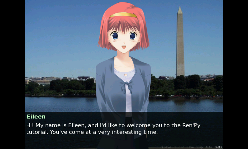

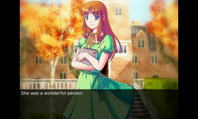

That said, playing a bit with setup.py and setuplib.py, I managed to make a semi-working build. Now games can be started and played, but with the following drawbacks:
- It's still working in software mode so...
- Performance is very slow and effects (for example soft transitions) don't work.
- Sound is not working :blink:

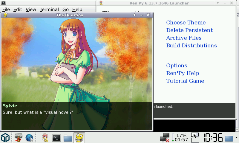

Three new screenshots:
