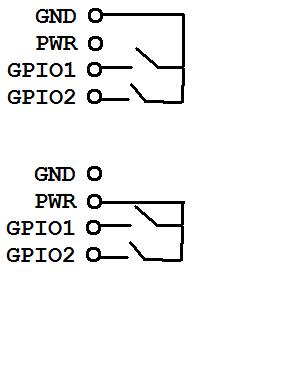

For the person asking for a circuit diagram:
Don't feel bad, it's actually healthy to feel daunted when you're told to look in a 3456-page reference manual to get some buttons going. Look! It's right there, on page 775. Easy, just set these bits in these registers and off you go!
If I understand Exophase correctly, he was explaining how to enable the built-in pull-up and pull-down resistors on the GPIO pins (they are there after all!). That's actually very valuable information, so thanks for that! But it scared the hell out of me too. :)
That doesn't mean that *has* to be done for your idea to work. It could also be achieved by external pull-ups (see that pullup/down link I posted).
