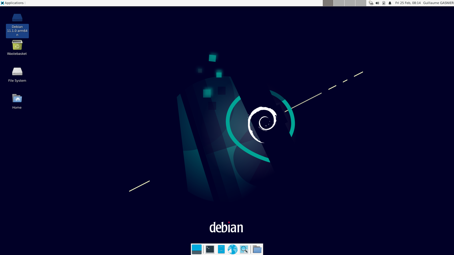

Debian 11.1.0 on Phytium after changing the SSD by a Gigabyte's one
Seems to work with this one.
Have to build the Phytium kernel or something else to test for stability

No problem with the SSD included with the Phytium. I prefer to keep it unchanged.
I installed XFCE.
