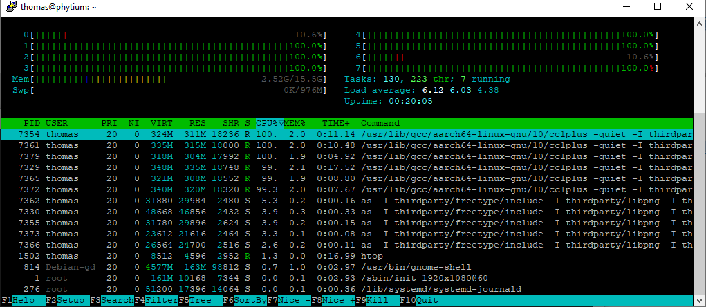

Strange effect when compiling Godot. The system stopps during compilation, had to switch off the system. After reboot, there is no entry in the message log. This happens two times now.

Tried another power supply, but during compilation process a clack/clack comes from system and it doesn't response any more. The lid is hot, can only touch for short time.
I think there is something wrong with the fans even both are active.
How long does your compilation job take? Maybe the current cooling solution is barely adequate for full load over a long time. Not all silicon is build the same and perhaps your D2000 cannot cope with heat as well as others.
Could you try again while the case is open and check whether the CPU heat sink gets exceptionally hot?
Case is now open, compilation time about 18 minutes on 6 kernels before the system stops, an the cpu is a litte warm, but not hot.

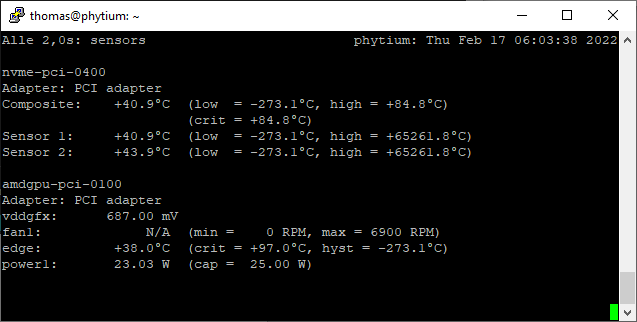

lm_sensors found sensors for nvme and gpu, nvme is around 41°, gpu stucks at 38°, only minimal changes during compilation, but no sensors for cpu.
Thomas
So it still crashes, even when the case is open? With enough airflow it should definitely not overheat. The SoC has an integrated temperature sensor, but the necessary modules (CONFIG_ARM_SCPI_PROTOCOL, CONFIG_SENSORS_ARM_SCPI) aren't enabled in the Debian kernel. Even if they were, they are missing a few patches to get their configuration from ACPI. If you still have the phytium kernel (from Kylin) you can use it with Debian too, to get a temperature reading. Maybe the heat sink is not correctly fitted on the SoC. You could remove the mainboard and take a look. Perhaps there is a visible gap/space.

A question though. Did you by chance replace the SSD with another one? Your's has 3 temperature sensors, while the original (HS-SSD-E2000L) has only one.
# nvme list
Node SN Model Namespace Usage Format FW Rev
/dev/nvme0n1 30057869073 HS-SSD-E2000L 512G 1 512,11 GB / 512,11 GB 512 B + 0 B U0914A0L
# sensors
nvme-pci-0400
Adapter: PCI adapter
Composite: +25.9°C (low = -273.1°C, high = +82.8°C)
(crit = +84.8°C)
Yes, htop shows 20:05 minutes, compilation was only 18 minutes.
And yes, replaced with a Samsung EVO 970 Plus NVME, with the original system as a backup in case I did something wrong.
I'll swap it back to see if it's related. I also ordered an infrared temperature pistol, but it won't arrive until Monday.
