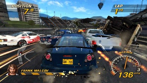

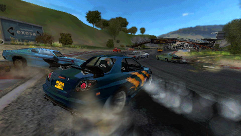

Bitching about mobile graphics:
I thought the teams behind tekken and flatout: head on did a good job
You should keep in mind that mobile graphics had the fixed function pipeline which limited them very much, Tekken for example uses the ghosting of the PSP screen for anti-aliasing by jumping the picture. If you take a screenshot it looks like the above, but if you play the game it looks really smooth - its a damn great idea!
However, with the Pandora we get full vertex and fragment shaders, I prepared about 20 shaders until now, some for post-processing, others for material effects or effects. I would say that you can get graphics at xbox level. Maybe not so much geometry at once (which you don't need at a small screen) but with the same looks - or even better.
Mmm, tasty! :) This is the 3D Graphic Quality I want to see onto the Pandora.
