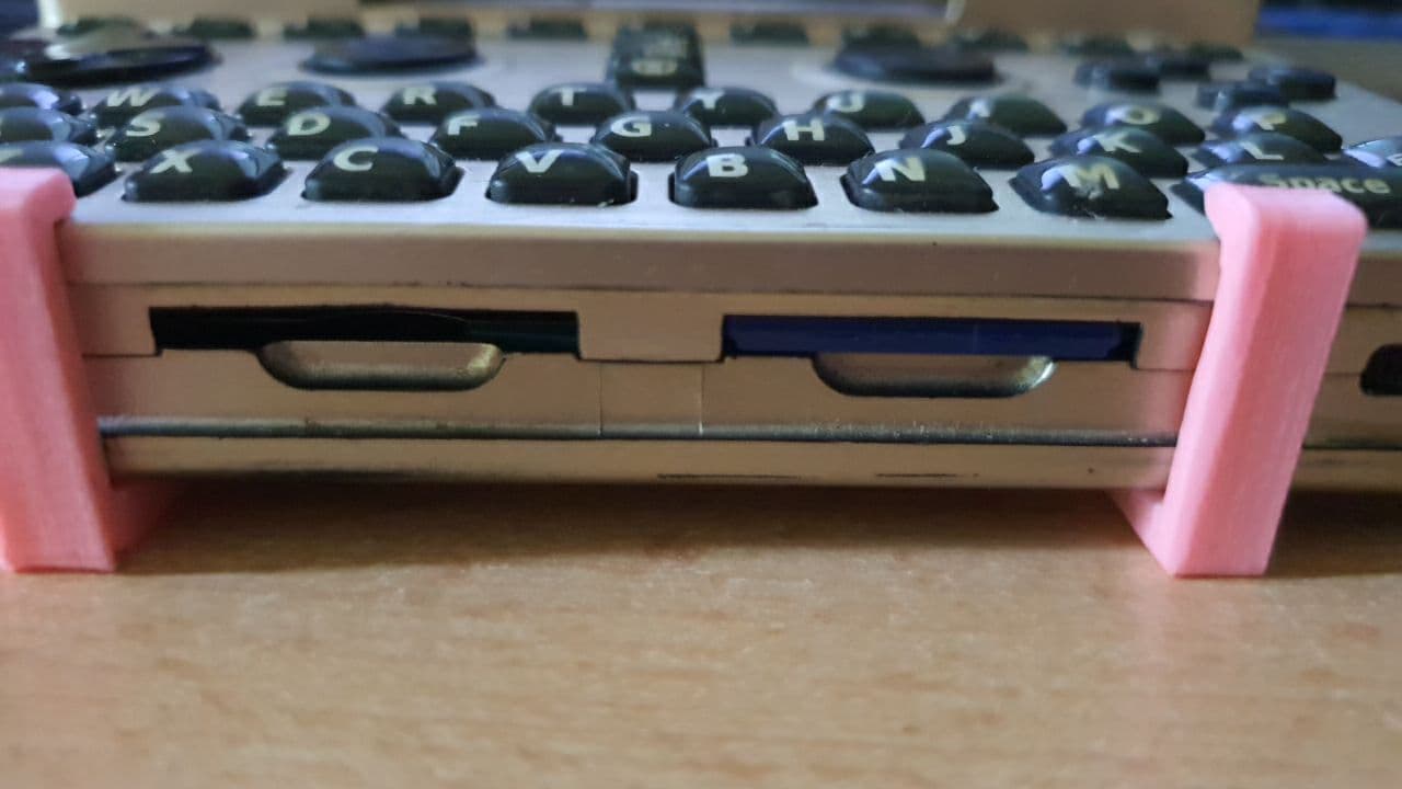

Maybe a Way is to solder the defective String of SD Card Slot with a Short Cable onto Card itself.
I think it's only the outer casing that is not connected anymore so probably a ground or something. Howerver it is hard to see where it should be connected.

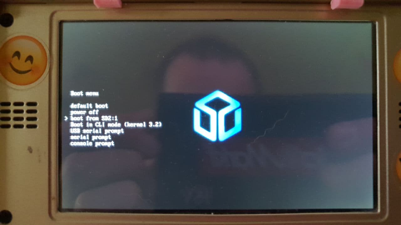

i can confirm that with Pictures:
Maybe you have an older U-Boot Bootloader on your Pandora.
Notaz definly added an Option to boot from SD 2:1 for flashing but i did not found the Right Thread.

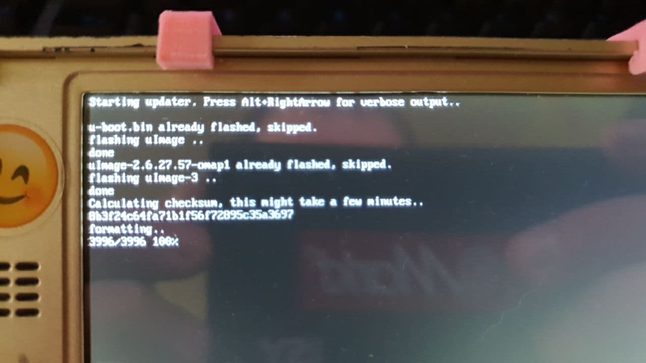

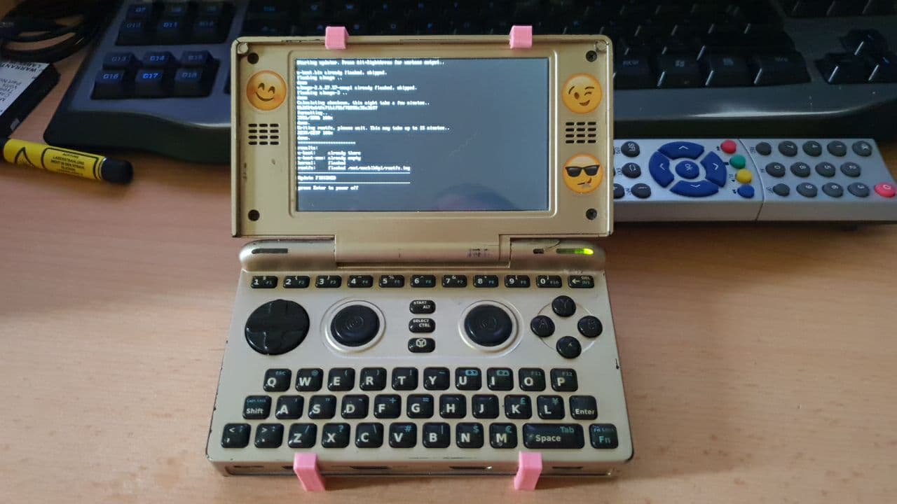

That was simply with the normal extracted Flash Files on a 2GB Fat formated Card:
Holding R Button while poweron.
Boot from SD 2:1 and reflashing work fine:
