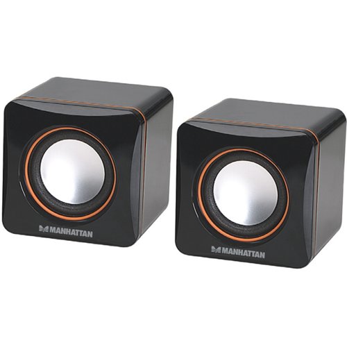

yea i had a few i had to give a little extra push in, they were fatties. got these sweet tiny usb speakers at a local electronics store for 10 bucks 226198882.jpg
have 2 sets and have great sound fills up my apt.
