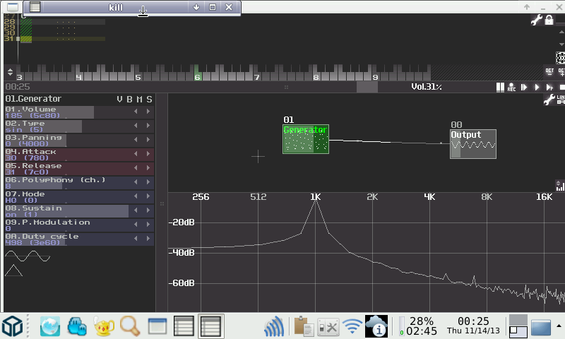

Depending on how precise your frequencies should be but you can use SunVox. Insert basic generator module where you can switch between sin/sq/saw/noise, activate the spectum analyzer and use the onscreen or hw keyboard to play the notes. There is also Touch Theremin-like XY pad to get the smooth frequency transitions.
Attached is the song file with pre-prepared sinus generator ;-)
Edit: Screenshot shows C6 note which is 1046.50 Hz according to this. Analyzer seems to be right.
