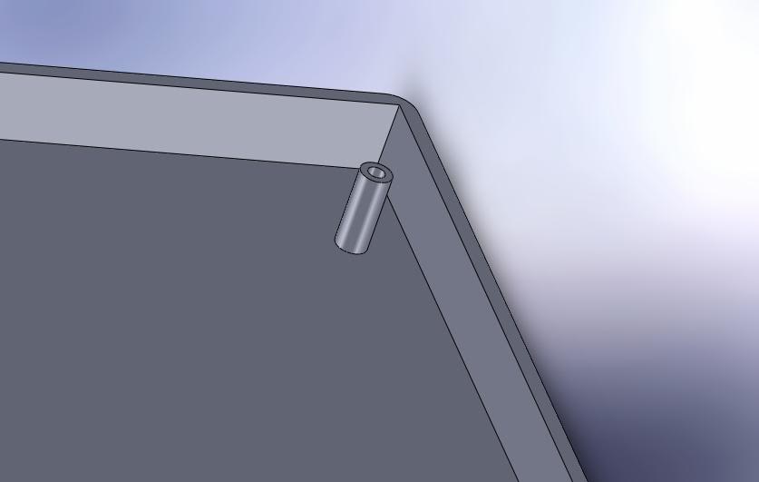

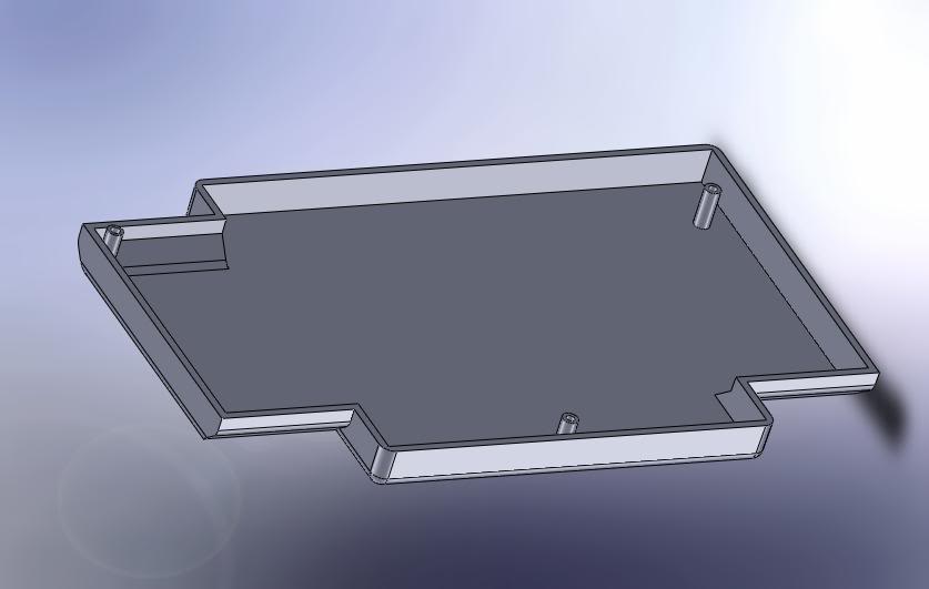

Gruso i will post a 3d model in the next few days.It is going to about 9mm thick i want to leave to top open to make it thinner.On one of the first pictures released of the case you can see that the outside case has 3 screws i think i can use this to attach the docking station with longer screws actually about 9mm longer.Ill put up a picture later of a model i am working on right now just so you guys could get an idea of what i am doing .

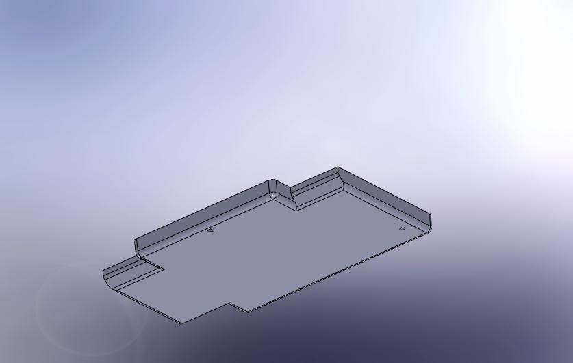

This is a basic design of the Pandora docking station that i am working on all the measurements are made up.Do you guys have any suggestions?
Ah that was quick. What does the odd shape allow for? Any chance you could knock up a quick concept of the final overall arrangment including Pandora, with some labels and stuff? Wireframe or even hand sketches would do.
We're going to need a sketch of the Pandora in there. I have no idea how it's supposed to fit, sorry.

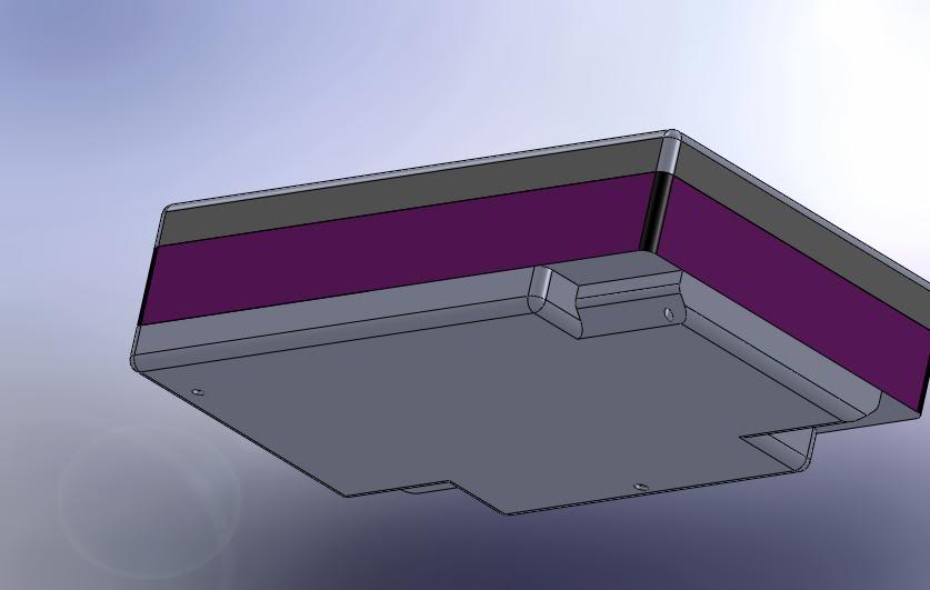

This is just a simple sketch of the Pandora just to see how it looks with a docking station so please don't bash me.
oh, thanks!
I was expecting the Pandora to fit inside it, so I was a little confused.
"please don't bash me."
I'll try to be constructive, then:
I think it will be inconvenient to use screws for a docking station. Most use latches, I would expect something like that, though it depends on what the station's supposed to connect to on the Pandora.
If it's just like a stand to hold it in place, you can probably build more like a box and rely on gravity.
If it's supposed to have connectors too, I'm not sure. I don't know where all the ports are on the Pandora.
But screws are pretty slow, I'd only use them if it was going to be in there for a few days at a time.
Ahh I get it now. Still, curious about the shape. What are the design reasons behind that? Does it need to fit in with some other thing we haven't seen?

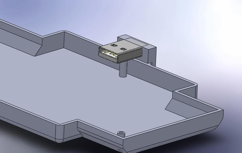

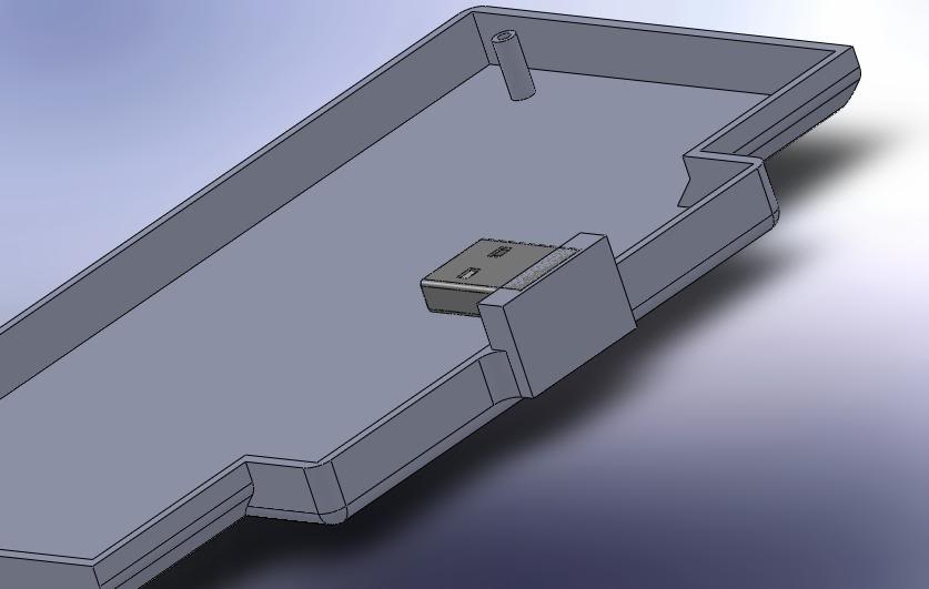

Ill add all the other stuff later like connector to the usb port.I don't think this can use latches because the Pandora is not designed for that.Ill put up a picture right now with a usb connector.Gruso the pieces missing from the shape are for the stylus and the two in the back are for the back buttons.Ill keep posting more pictures in a few minutes .
