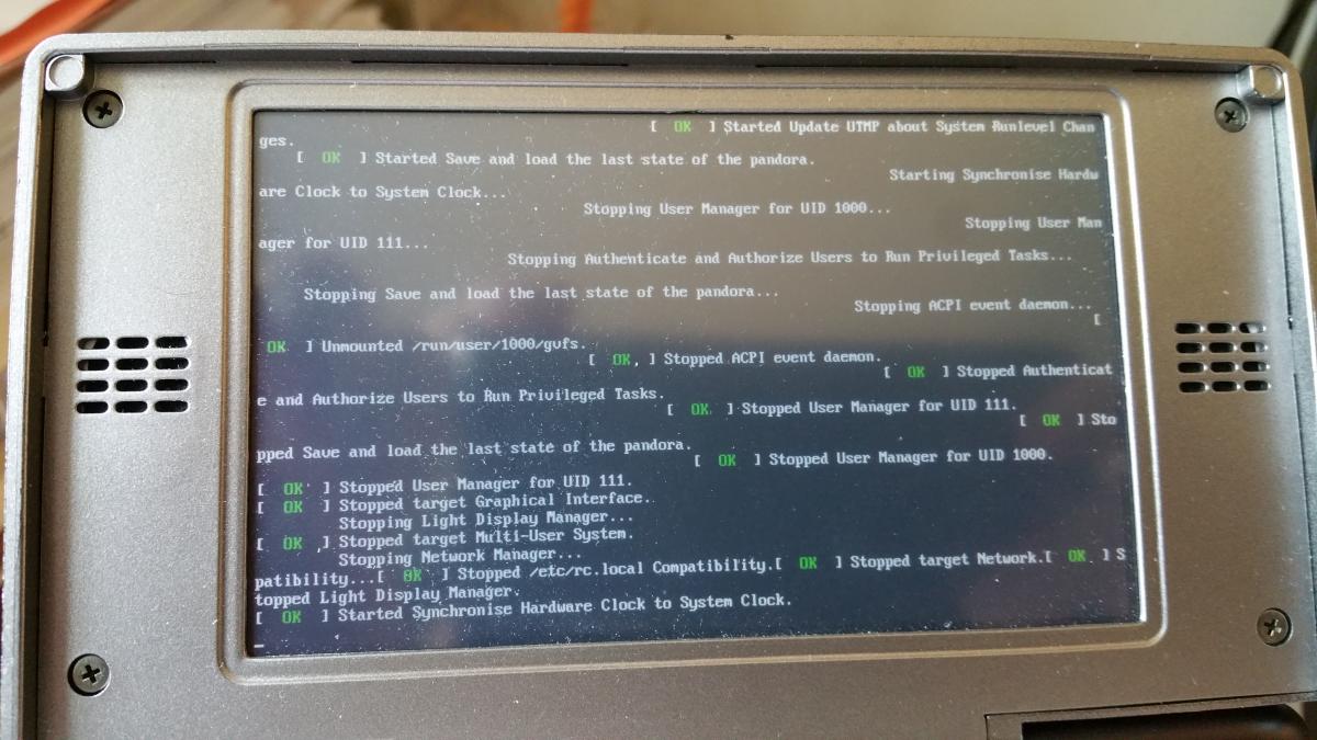

2 - Shutting down in fluxbox from the menu doesn't seem to work. It tried but then it hanged/crashed?
3 - Restart in fluxbox doesn't do anything.

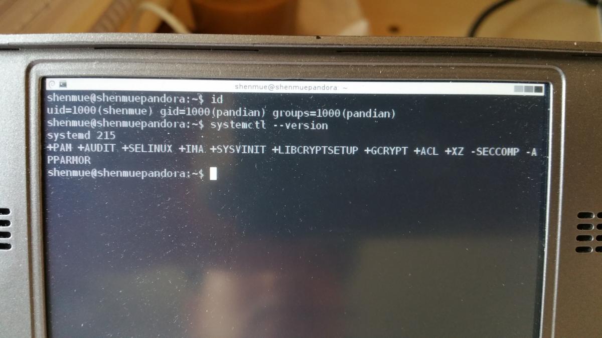

Did you have additional hardware plugged in ? Normally the shutdown command is "systemctl poweroff" please try this command in an terminal.
Did the command just do nothing, or just "hang" at shutdown ?
For Additional information, please open an Terminal ( ALT+F1 ) and give the output of the following commands:
id
systemctl --version

"systemctl poweroff" works properly but not "shutdown" from flux menu.
Here are the ouputs.  The first one is of id and systemctl --version, The second image shows the crash/pause (it just stays in this state)?
