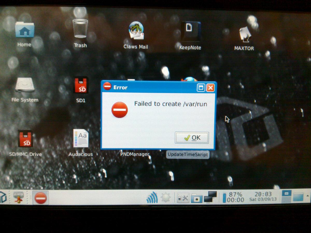

Some time ago I wanted to try wheezy, but it aborts after a hour the installation every time with "failed to create /var/run ..." (can't rembember exactly).
Sorry, I'm a linux noob, did I have done anything wrong or is there a special trick to get the wheezy installation working?

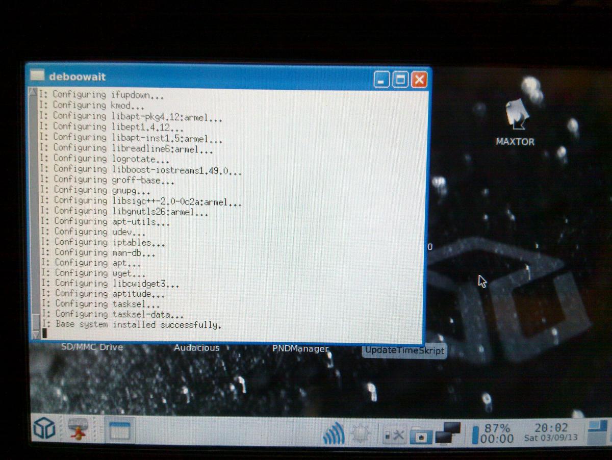

At the beginning everything runs fine:
But then I get this message:
I'm running the latest SZ 1.53 on a Rebirth Pandora. I've also tried different SD-cards... always the same result.
How did you guys install pandebian wheezy?
FWIW, I just installed PanDebian and selected wheezy....but I noticed that when installer got part about installing packages, it showed it was using squeeze repos....
So, I assume that the open to install wheezy, really isn't working yet....
When I looked at Gregor's PanDebian blog, it notes that he added wheezy as an option, but it was untested.....so, think we've now tested it and it does not work....
Going to try upgrading to wheezy manually and see what happens...
Aha! Thanks for this post - I also tried to install Wheezy fairly recently and left Pandora installing several attempts with no success - I was ready to pull my hair out.
I'll give this another try with Squeeze!
Well I tried again but with Squeeze and it installed correctly!
First thing I tried was installing Osmo and... it works, no segfaults! So now I finally have an awesome PIM working on Pandora... but I used a Spare SD and I really want Osmo on my main SD!
I'm also going to try and install Steam Linux using Linuxbochs WINE/Qemu/LibGL stuff... I have a feeling I may be able to install the deb file and dependencies will be pulled in... hopefully.
I successfully updated from squeeze to wheezy with a similar method as shown on this page.. http://www.howtoforge.com/how-to-upgrade-debian-squeeze-to-wheezy
The source list file shown has a little different look then the one shown, but you basically just need to swap squeeze with wheezy, run the update commands shown and that's it.
