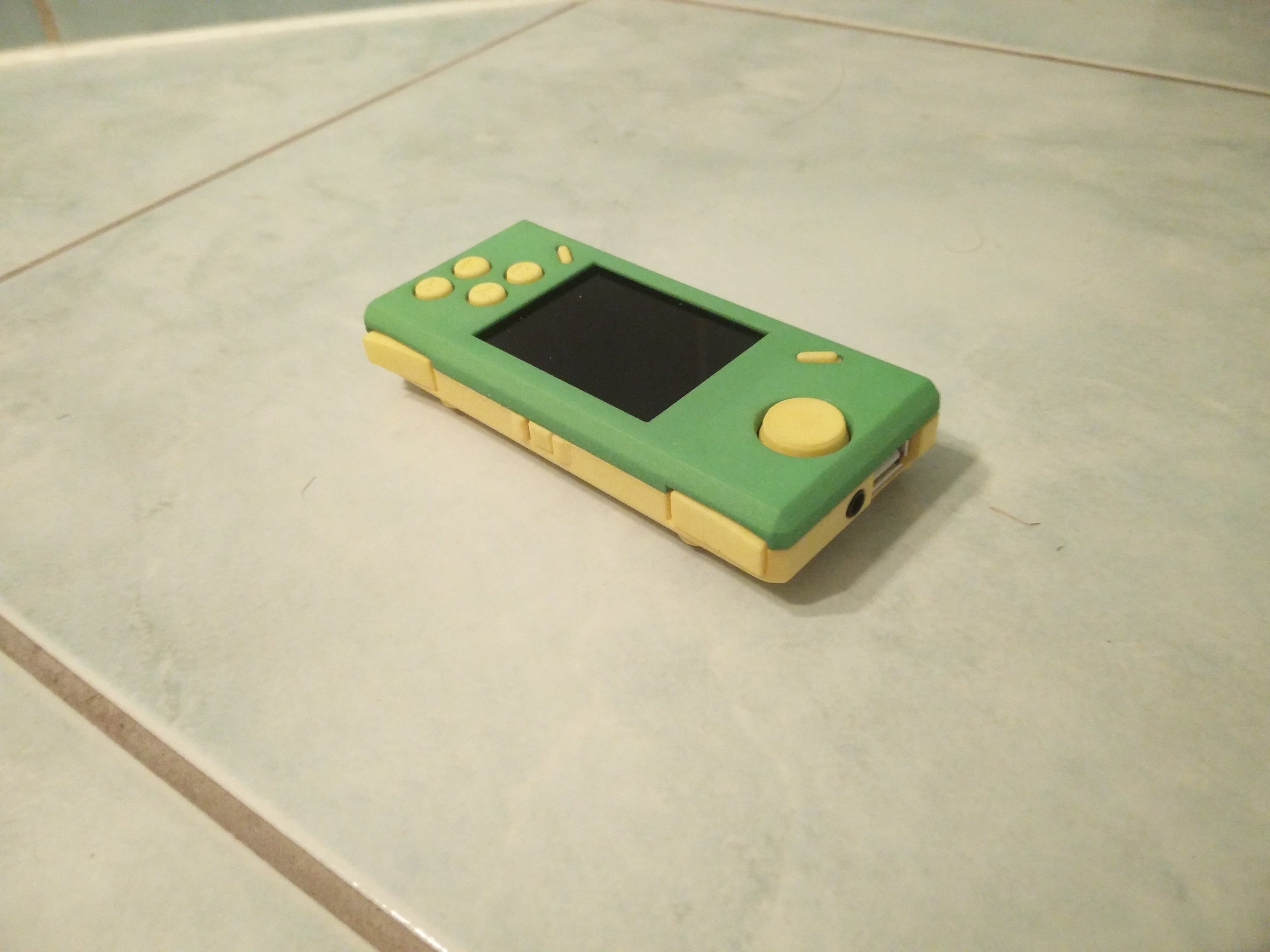

I finally ordered one case on shapeways... It took me some time as I had to edit some parts a bit to match shapeways rules... It wasn't easy for a first... I took a polished green top and all the rest is polished yellow :) it's marginally more expensive than the white one... I'll probably will test some more expensive materials for my two other cases, but let's see how this one fits... I'll also need to assemble the two other units... Min quantity for the pcb was three and three sets of parts on mouser cost marginally more than for just one due to the free shipping minimal cost..

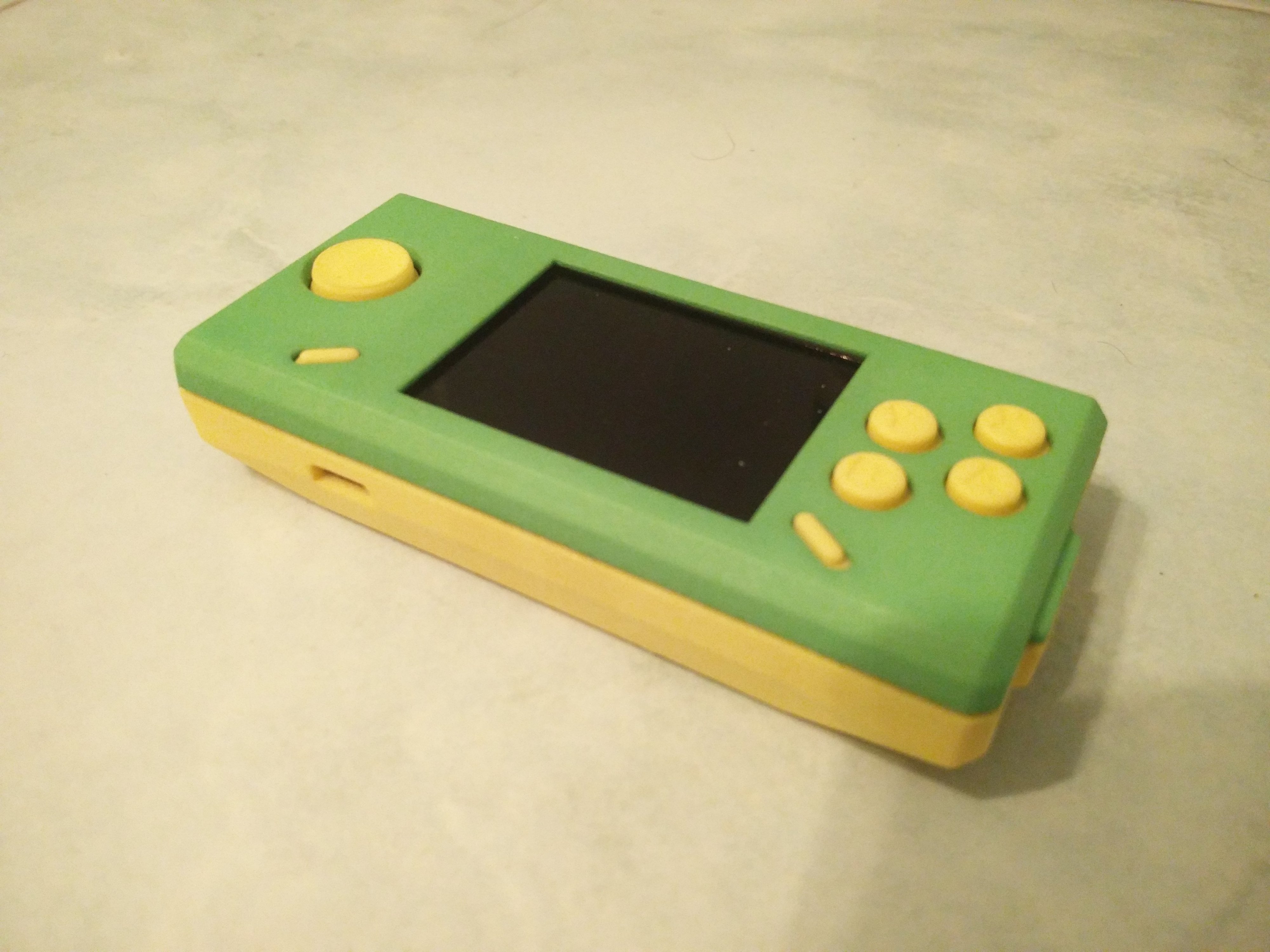

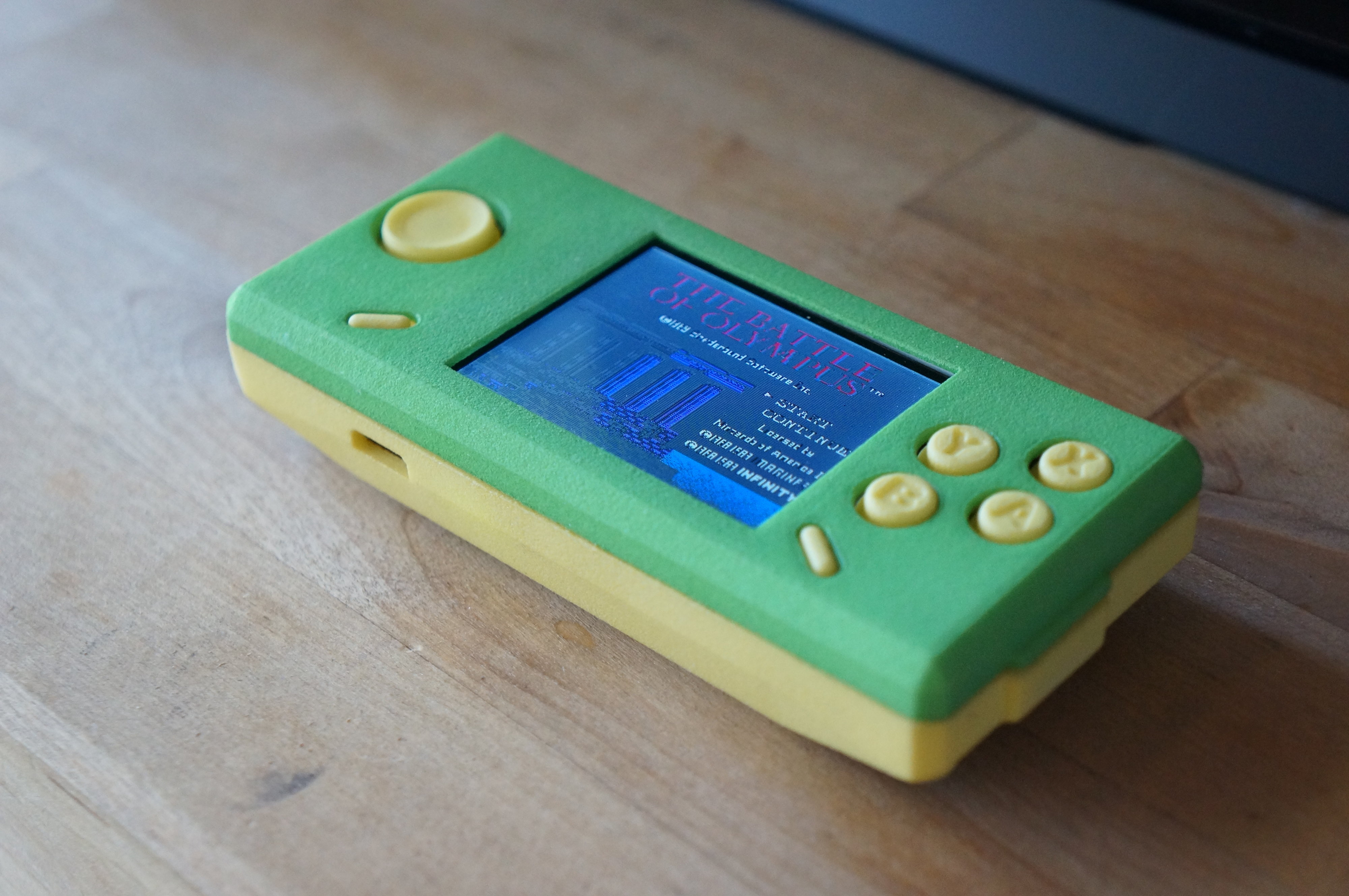

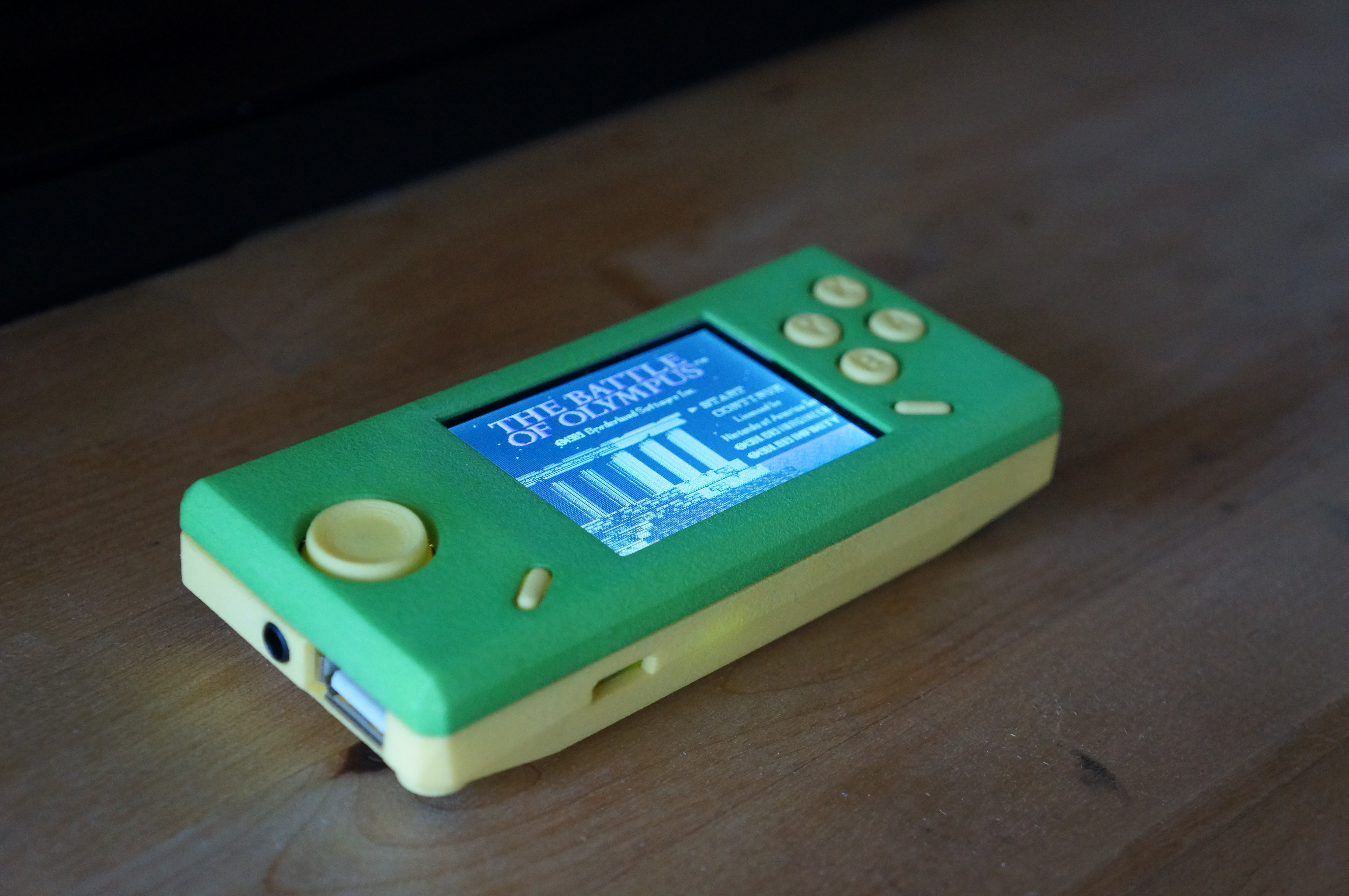

Ok, that's just barely mounted together... It still needs a bit of sanding (the start and select are almost pressed when the case is correctly closed). I also still need to order the final batteries and find a way to add threaded bolts. I'll probably use some cut down spacer with epoxy for that...
Sorry for the long time without update...
I had a business travel and I had to wait for batteries...
Not all is perfect through...
  • there's some space between top and bottom shell...
  • the clicky switch selected are pretty good, but it still do not compare well with membrane ones...
  • audio is really noisy, but I guess this is my fault, I suspect it's because the LCD I used has no shielding while the one in the original project had a small metallic support. that or it was noisy too.
  • the pi zero is quite power limited, out of the box without any configuration, some PSX games are slow, even some SNES one do not run so well, there's for sure room to make both these console run well, but the pi zero is definitely not the same beast as a pi3...
  • the screen as not a great view angle, and it's a portrait oriented lcd, it's not great to have some left-right differences.
but altogether I'm really happy with the result...
now I'm not sure what I'll do with the additional hardware for two other console... I was going to build them, and probably offer them at cost on tindie or such, but I got some really surprise when ordering the case... basically shipping + TVA + UPS special examination tariff means that I paid more in tax than on the case part, and the case including taxes end up costing more than all the component for 1 piboy zero... not fun...

I haven't run extensive test for performances... In fact I only have one psx game on it, it's gran tourismo, and I suspect that it is a rather costly to run game... It runs a bit slow, like 2/3 of the speed, and that's on simple tasks like licenses tests, it is probably worst when other cars runs... This is with the stock options, I think we could get way better performances, and I am fairly certain that simpler games (rpg...) will run perfectly there...

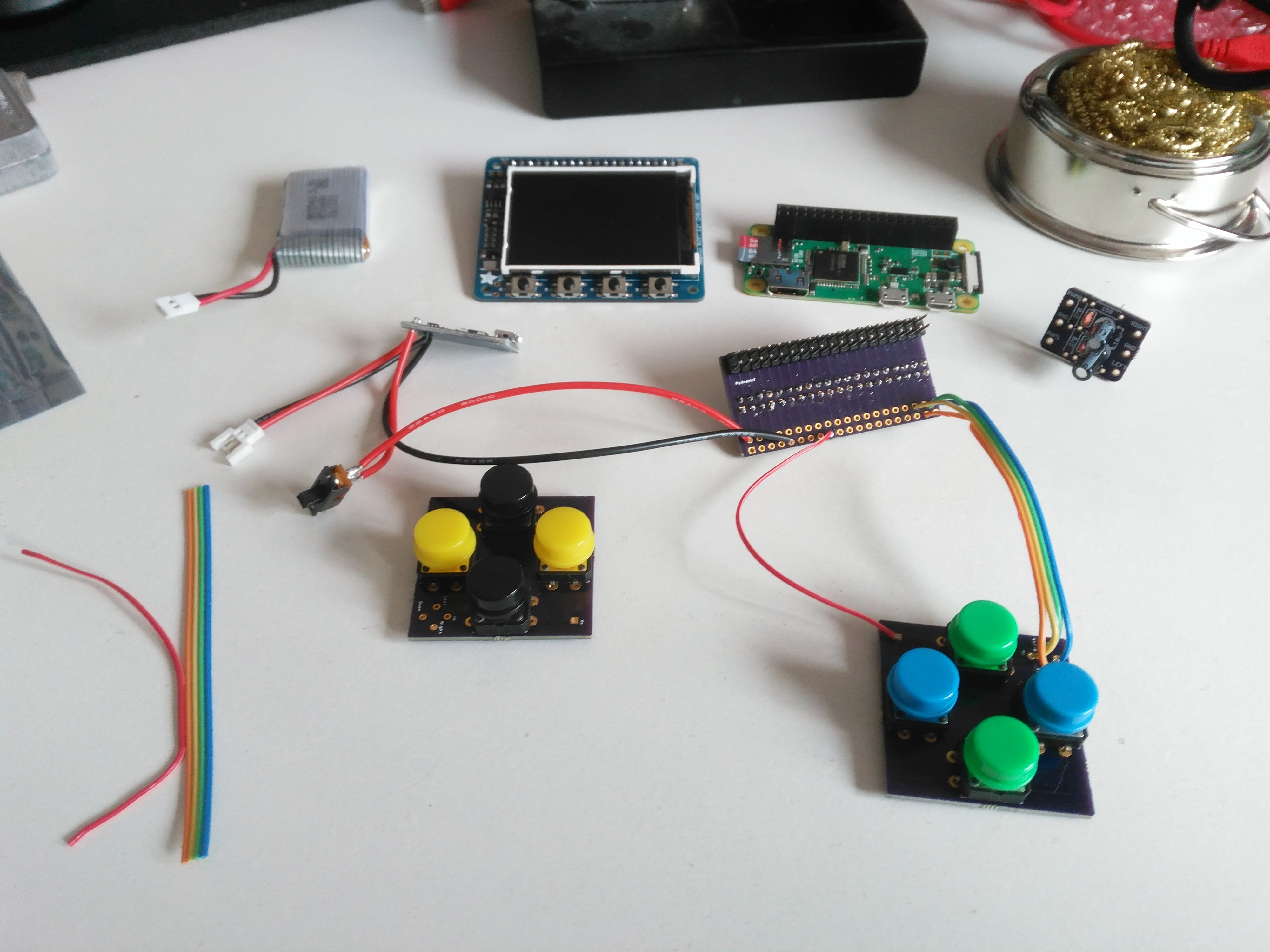

Mine's slowly taking shape... Though to be honest, I've not even thought about the case yet. Originally I was thinking of trying to cram it in a GBAdvance case, but I decided to have a play and designed some of my own circuit boards, so I think my overall set will be too tall/deep now.
Thought I'd carry on soldering everything anyway, just to see if I can get it all running nicely, and worry about the finer details later :) Probably start looking at writing the virtual keyboard software soon, as I'm not planning on this just being emulation station.
