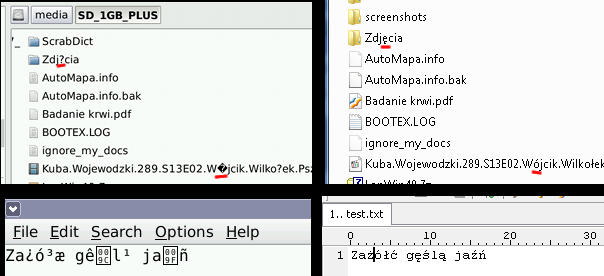

Hi, I have been playing with my newly received Pandora for three days now (got it two days before my birthday - it's the best birthday present I've ever got, despite the fact I had to pay for it :D ).
I was learning it for the time, and managed to solve some issues that came out (mostly by searching the forums). I have left with two of them:
1. This one is really important, as I would like to use Pandora also for writing texts: How to set it up to display national characters correctly? I'm Polish and we have some of the national characters, but none of them is shown correctly nor can be typed from the keyboard on Pandora. I've searched for topics with similar problems but haven't found anything. Here is the image to show what I'm talking about. On the left side it is how it looks on Pandora, on the right - how it should be looking (how it looks in Windows).
I couldn't find any regional/codepage/charset settings in the system.

I'll try to answer your first question.
I think the problem in the text in your picture is the character encoding - it looks like ISO-8859-2 or (worse) CP1250 (WinLatin2) to me, while you should use UTF-8. The Pandora is fully capable of using UTF-8 encoded characters; I'm using this feature myself, learning Polish.
There is a (not so convenient) method to input special characters: first press <shift><enter>, then two characters (one after the other) building your desired character. Thus you can write ę (<shift><enter> <e> <,>), ł (<shift><enter> <l> </>), ż (<shift><enter> <z> <.>) and so on.

Thank you for the answer.
It may be CP1250, as Win 7 seems to be still using it (for backwards compatibility maybe?). So the reasonable solutions would be:

I have tried to do the latter, according to this article, but it didn't work. The article tells to call ipkg list 'kernel-module-nls-*' in order to find the available charsets. The is no ipkg on Pandora, but I have browsed /lib/modules/3.2.17/kernel/fs/nls/, and there are only two files there: nls_ascii.ko and nls_utf8.ko. I guess utf8 is default, so I tried using ascii one, and the result is similar (characters are still wrong). I guess I need an nls_cp1250.ko or nls_iso8859-2.ko files to make it work? Does anybody know how to get them? I don't mind compiling them by myself, I just need to know where to start :) .
Thanks, this one works, though it's a bit painful. How comes there is no simple way for this? I've just run my Linux box and I can easily input Polish characters with right Alt. This key, also called "Alt Gr(een)", is a shortcut for Ctrl + Alt. However it doesn't seem to be this straight in Linux, because Ctrl + Alt doesn't work (but it works in Windows). But since I can easily type Polish characters in "normal" Linux, why can't this be done in Pandora? Yes, It doesn't have right Alt, but we could use another key combination for it, like Ctrl + Alt, or Pandora + Alt (though Pandora + Ctrl would be more convenient). I've read about Xmodmap, but I don't think this could be done with it. Or maybe I'm wrong?
