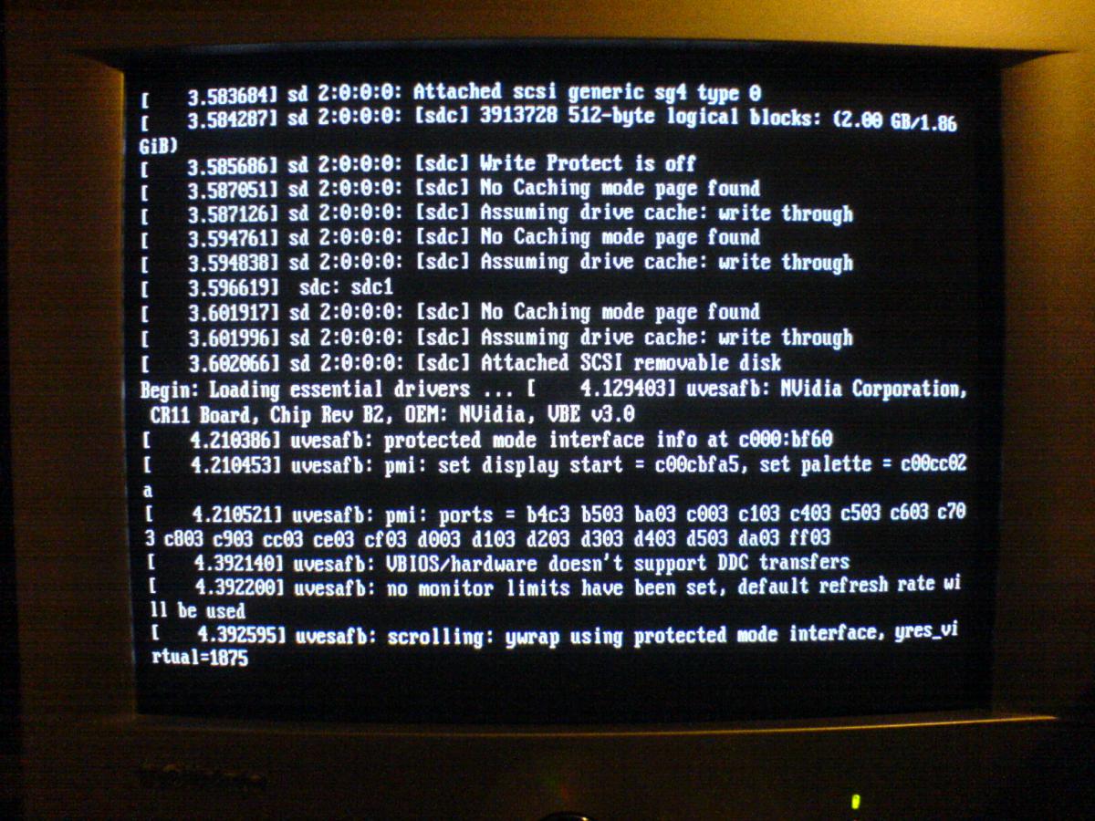

I found that the options are taken from the "syslinux.cfg" in the USB stick, and in case of Linux Mint it is pointing to the "/isolinux/isolinux.cfg", so I modified that file adding the "nomodeset" parameter to all the voices.
Now Linux MINT start without killing my monitor anymore... but it still freezes... I attached a picture of what I see when that happen
