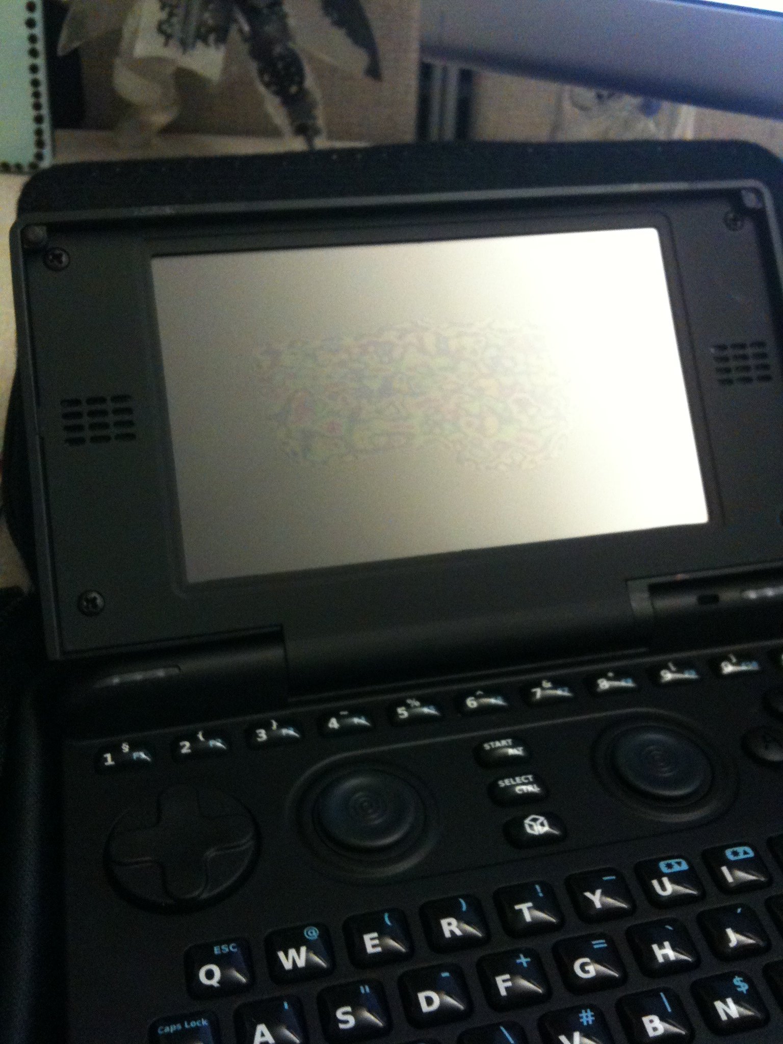

I awoke this morning to a sad site. This is my third day with my Pandora and on the screen I saw what I thought was finger grease and/or residue from the protective plastic sheet that it came packaged with. See the attached picture to see what I'm talking about.
When I tried to wipe it off, the discoloration moved around meaning it was actually under the screen. Has anybody else had an issue with moisture somehow getting under the screen? Is it possible for me to correct this myself without having to RMA my unit. It would kill me to RMA so soon after getting my machine, but the discoloration is pretty distracting when the unit is switched on.
Could you please elaborate a little on the discoloration?

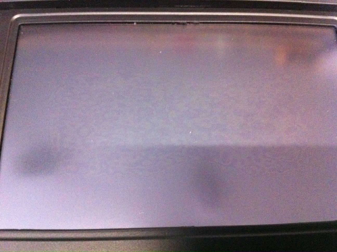

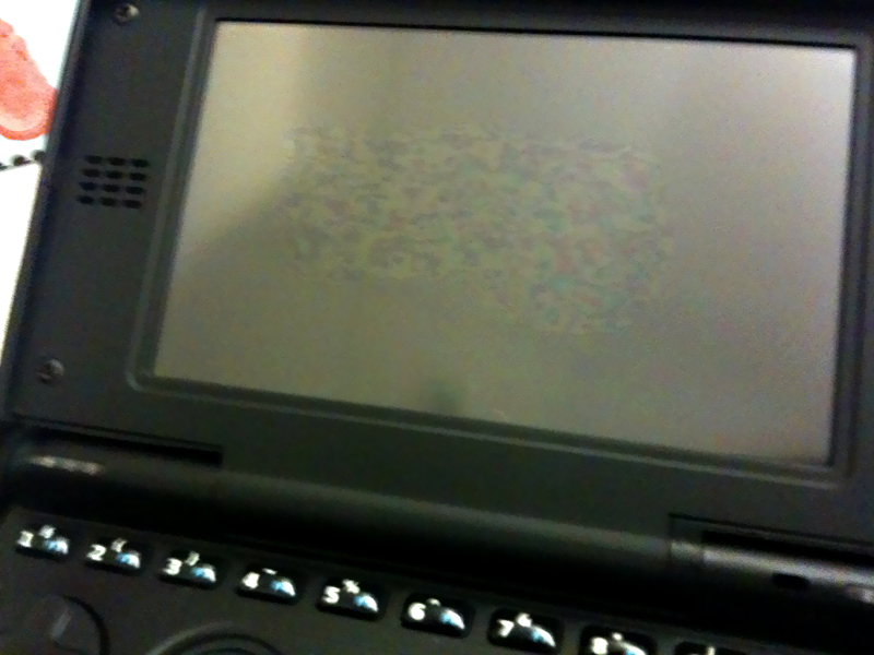

I'm not really sure how else to describe it. Its a spot in the center of the screen. It looks wavy and resembles oil when its on the surface of water. When light finger pressure is applied to the screen the spot changes shape and spreads out as if it is fluid beneath the screen. When pressure is released it goes back to this original shape. I can't really imagine how moisture got in there. My pandora has the screen bezel issue that pretty much all other Pandoras do, yet I don't see alot of posts about this specific issue. I'm posting another pic that is a little clearer.
I've got the same problem since day 1, it bothers me a lot, but since it doesn't actually affect gamplay or block anything I'm trying to just live with it though I am planning to RMA sometime in the future since beside this issue I've also got a broken mini usb port

Not sure that it's moisture but I have the same condition and it only is visible under fluorescent lighting that's directly reflecting on the screen.. so certain angles. Doesn't affect my view ability under normal lighting at all and it's unplayable if fluorescent light is directly reflecting off the screen like all devices.
Oh wow yeah that is the exact same thing that is going on with mine. I'm not sure it's moisture either but I thought it could be that from the way the discoloration moves around when you press on the screen. It doesn't make the Pandora unplayable but it is definitely distracting under fluorescent lights. Of course the perfectionist in me would like to have it fixed but I'm not even sure if I did RMA the unit if the next screen put in it would be any different.

Are you referring to the rice trick? It works sometimes. Unfortunately for me the patch of discoloration is still there, but again viewable only under fluorescent lights. If you have seen this before ED would you say its moisture? The nagging thought in the back of my head is that if it is moisture then one day it may short out the screen and then I will wish I had RMA'd when I had the chance. I of course don't want to send you guys unnecessary RMA's either though, so I'm really just hoping somebody can identify what is really going on here so I can make an informed decision.

It reminds me to some similar marks of my old palm3 and of another effect to LCD screens. Your moisture will look like it is moving if you are dragging the stylus with a small pressure over it?
LCD mean liquid crystal display, i think the distance between the screen layers (see wiki) is responsible for this effect.
If you apply a small pressure to TV screens, you will see changes too.

I'm also not so sure that that is moisture. Could be some very closely spaced nearly flat transparent sheets causing Newtons Rings.
See this:
https://secure.wikimedia.org/wikipedia/en/wiki/Newtons_rings
