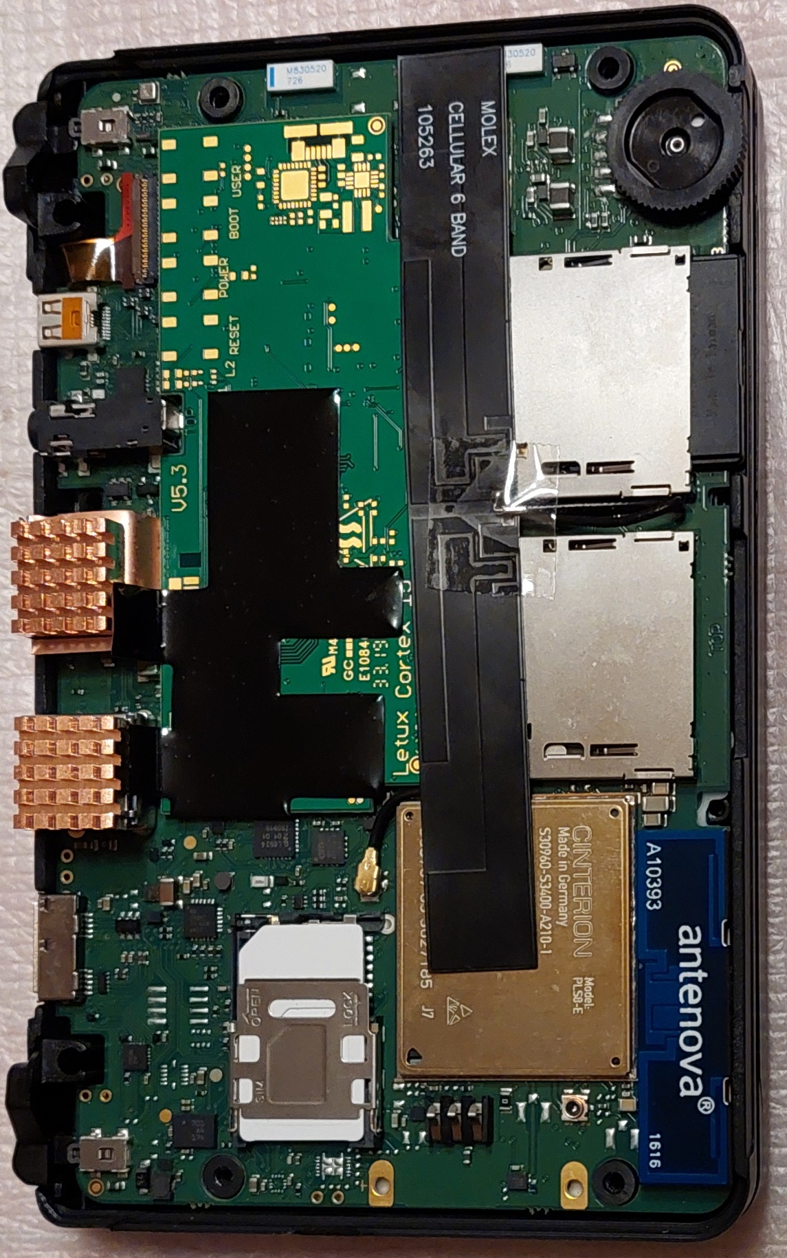

Have add a second antenna. May be is a bit better (have an mobile connection at home, yesterday not) but not sure. Have to try a bit more...

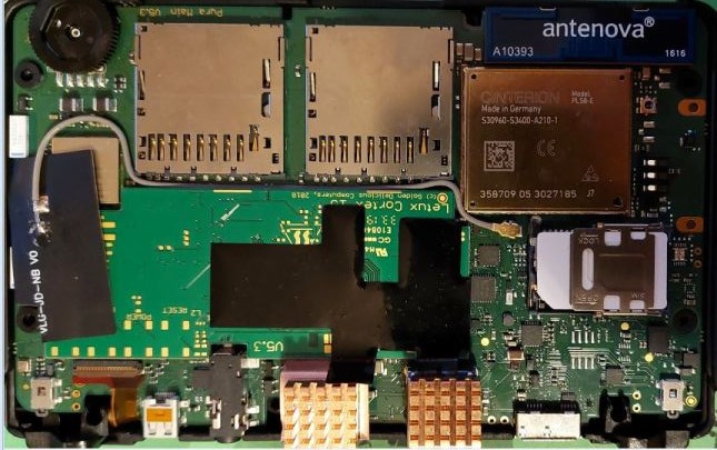

The antenna is from a quectel modem but I have no specifications.
Have read the A10393 datasheet. Looks like the antenna not support all the in Germany possible LTE frequencies.

Hmmm... but the datasheet doesn't mention any LTE support. Could it be the antenna we're usding does only support UMTS (and below) but no LTE?
Well, if adding such an antenna you are using is a workaround, then we could do the with the current boards and for the next production we could use a new antenna.
Different antennas or parts of one are required for different frequency bands. As before with VHF (First) and UHF (Second and Third), in case anyone remembers ;-) The antenna covers the frequency range from 824 - 960 MHz and 1710 - 2170 MHz. After 2019, however, 700MHz and 3.6 GHz were added. How the real ones are distributed (perhaps also differently for different providers), no idea. My solution is not perfect yet. It got better in some places, not in others. I'll keep looking for a solution.

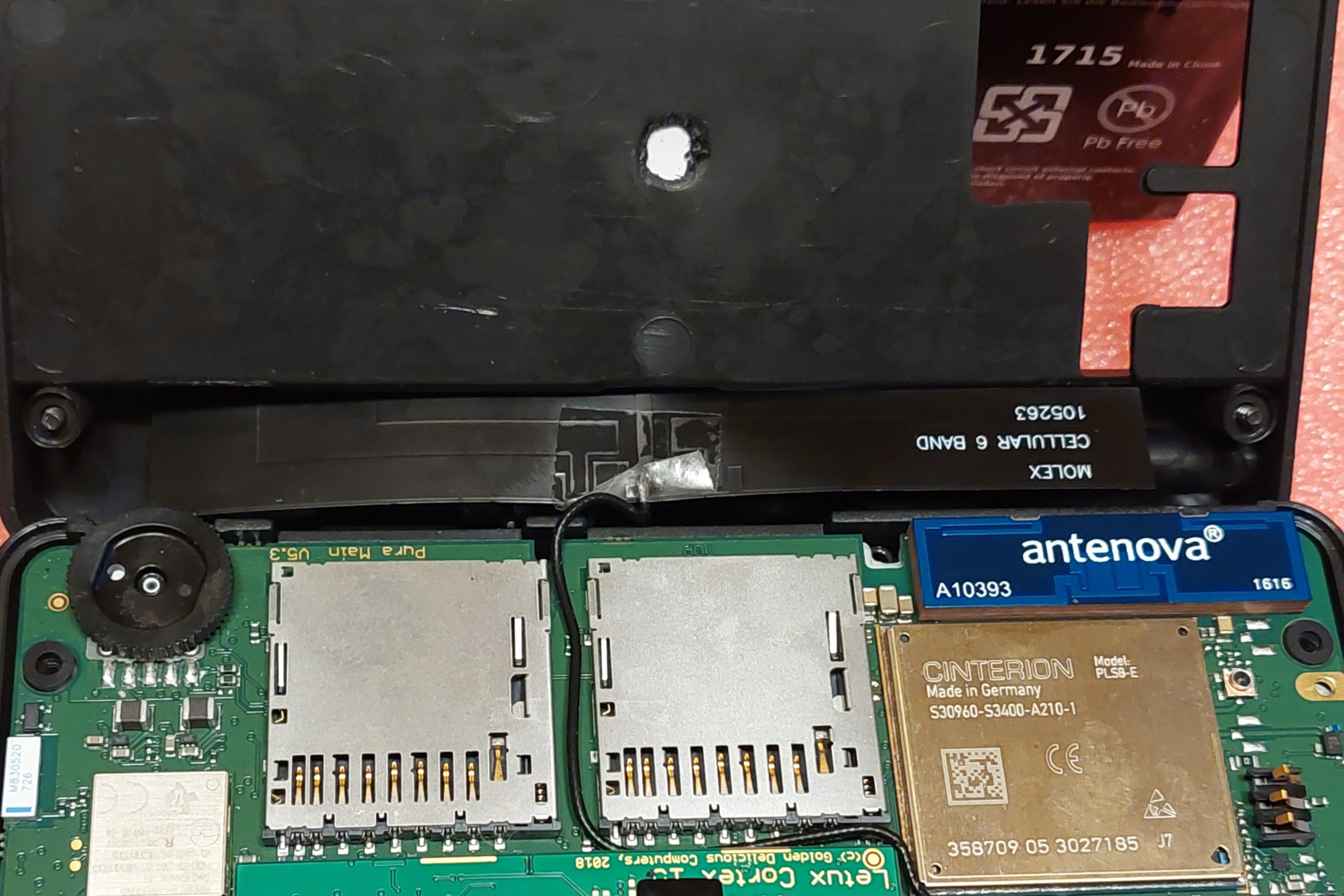

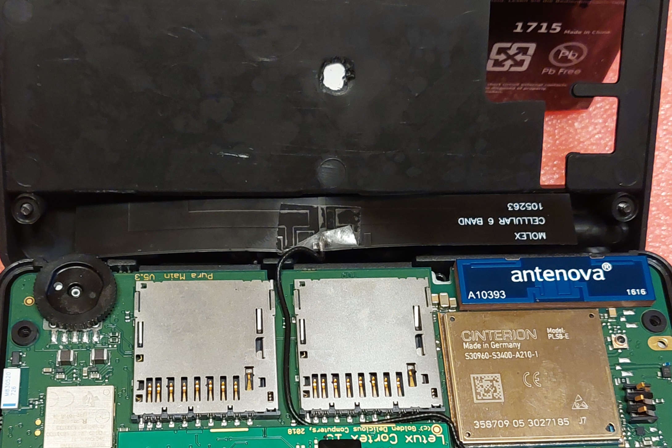

Since any weeks I have placed the antenna in the "pencil tube". There is enough space in it. Pencil and so on is usable.
Is a good solution for me. Makes my LTE more avilable and stable than without but is not perfect (my external LTE Stick is a bit better).
Is my solution for the next time. Maybe I find a better one but no hurry needed. In Berlin it works good now. ;-)
