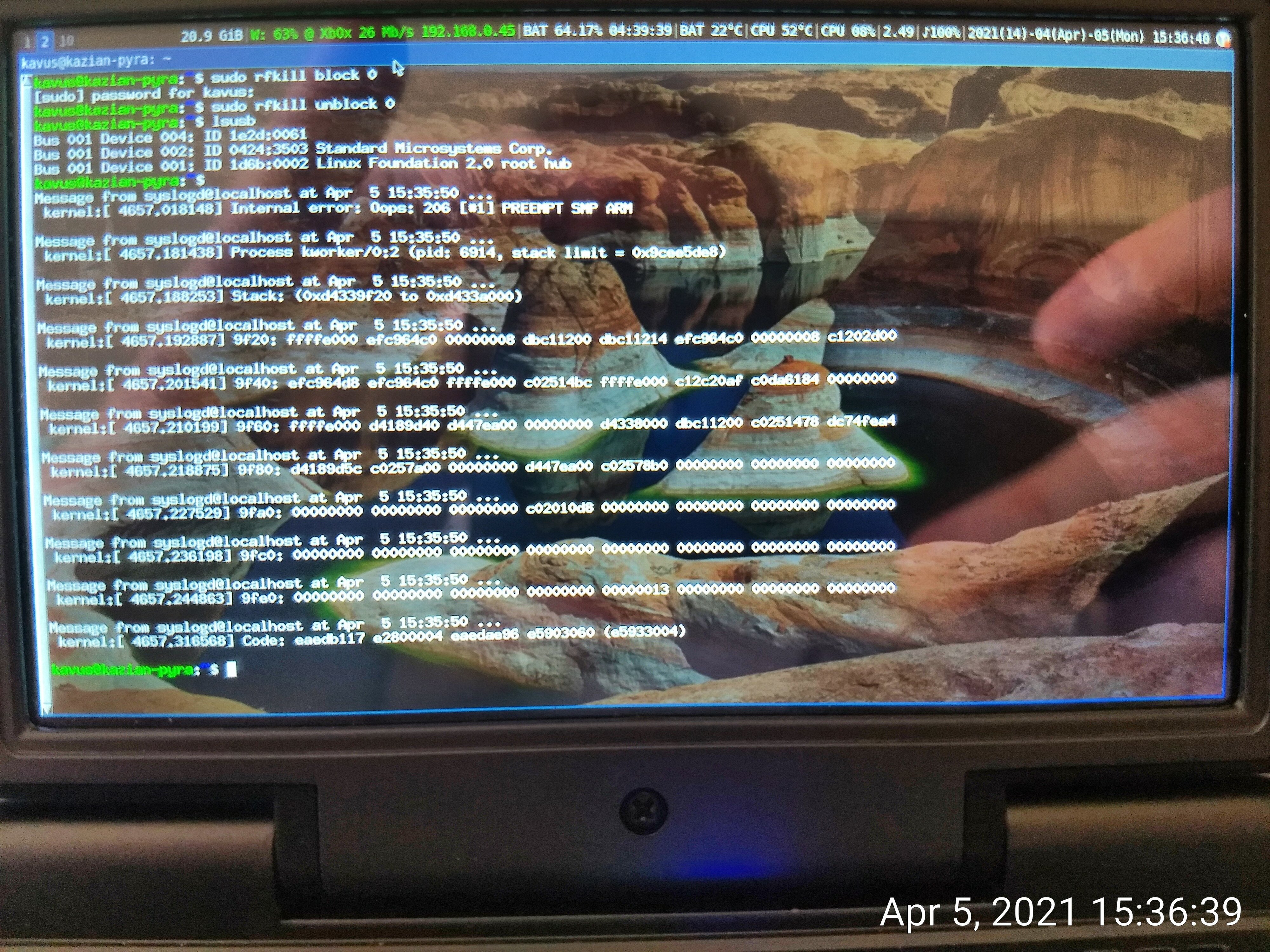

I tried rfkill unblock 0 again to see if I could to anything with it in cutecom, and then the Pyra did this. The nubs and dpad immediately stopped working at the same time, and then not long after, the enter key did as well. Very strange.
Looks like a crash report including a stack trace from the kernel itself. Presumably the kernel reinited giving you that prompt afterwards, and it's perhaps not surprising after an event like that that things are misconfigured. But I've never actually seen a kernel panic on my x86 boxen or my Pandora, so that seems strange to me.
Not an expert by any stretch but I have "successfully" caused kernel panics on my various x86 and x86_64 boxes over the years (including one where a hard drive head strike erased init. Surprisingly it was able to self recover that time with a fsck) and in my experience the kernel panics always dropped to single user mode and had "Kernel Panic" as the final line so I think this might be some sort of lesser severity crash. Either that or Ubuntu treats kernel panics differently than Debian.
